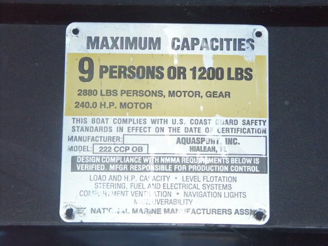

Look for the USCG capacity plate, it's a tag like this it should be somewhere close to the drivers seat.
Our gracious host iBoats also has some helpful info on your boat, appears that it will take up to a 135hp OB.....
