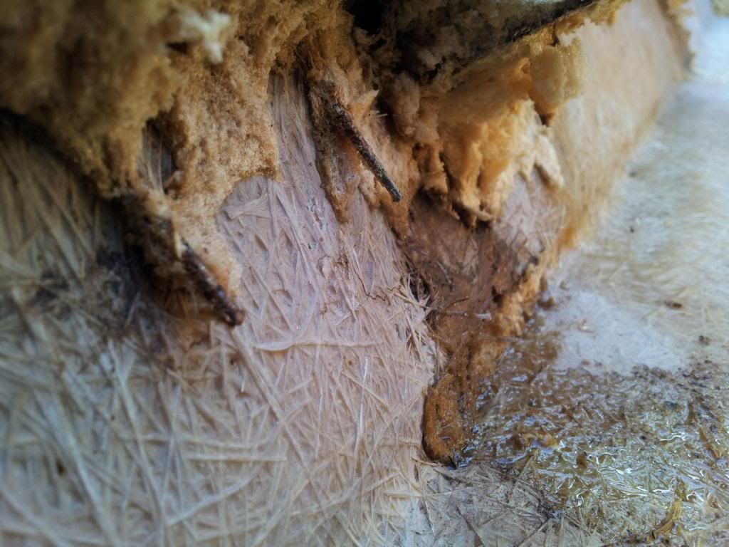

Yeah jigngrub I've seen exactly what you said about foam voids with blind pouring in my boat. It had a few big voids all the way to the bottom of the hull and that was from factory. Not that factory always means best work, just good enough to get it out the door. Between the info you have shared and others I think that the false deck method will probably be best. I'm also thinking instead of cutting out the channels on top to do something similar to what MWE is doing with the ropes, but on the top with solid pvc pipe so that it can be broken down and pulled out easier. It would have channels under at the hull and right below the deck all leading to the bilge. That should make this thing solid for more years than I plan on having it lol.

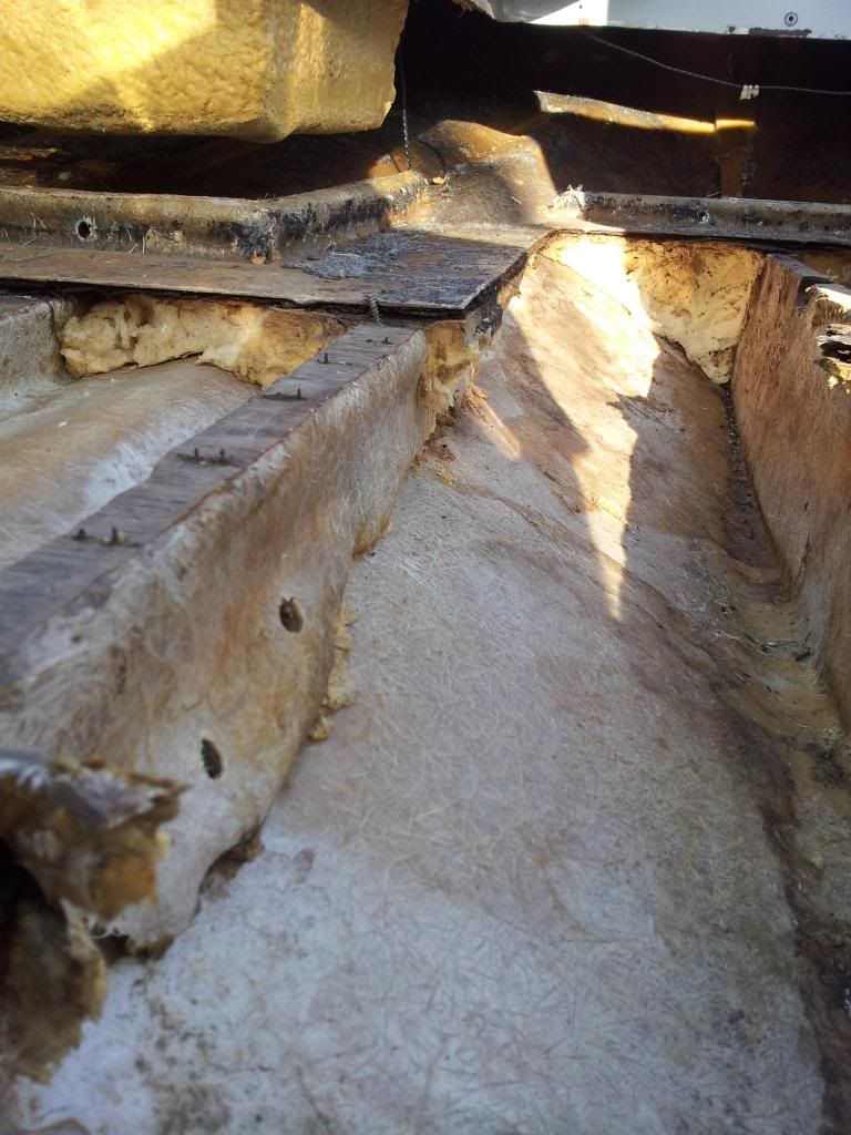

It still amazes me after having the deck off for a few weeks now that when I pull chunks of foam water comes pouring out sometimes.
I bet it will go a lot faster when all the waterlogged foam has been removed.
I'm also starting to think my boat was only worked on on Fridays right before shift end because the of the quality of workmanship. I know it was 1985, but really this is good enough for Four Winns standards?

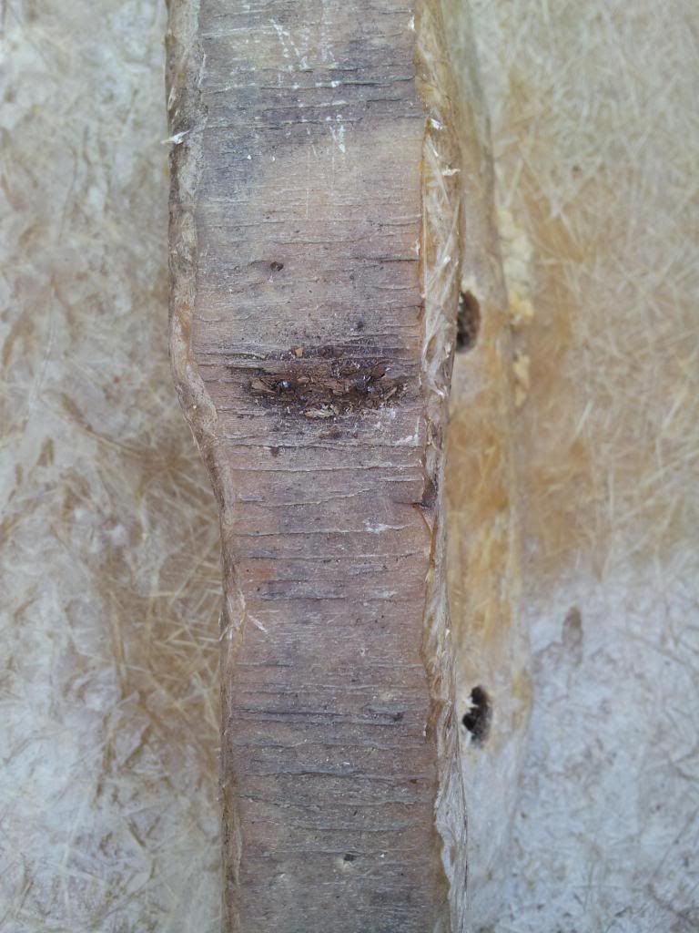

Limber holes???
Most often refers to any type of opening, passage, hole or orifice, usually at the lowest points on any substructure of a boat to allow water a way to get to the bilge...
In this picture you can see one that is located at the very back and bottom of one of my stringers..

Re: First resto project boat, question about foaming and draining.
Thanks for the pic GT, it never had any of those that I've found.

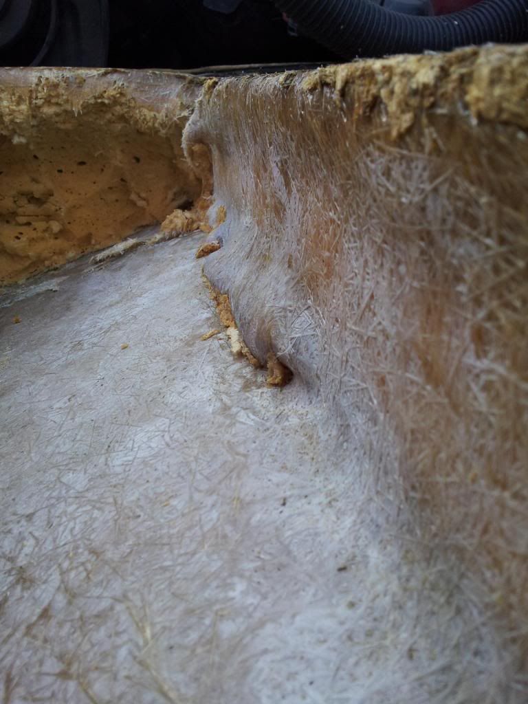

Glad it wasn't only my Four Winns that was glassed like end of shift Friday. I foresee a lot of grinding in my future!

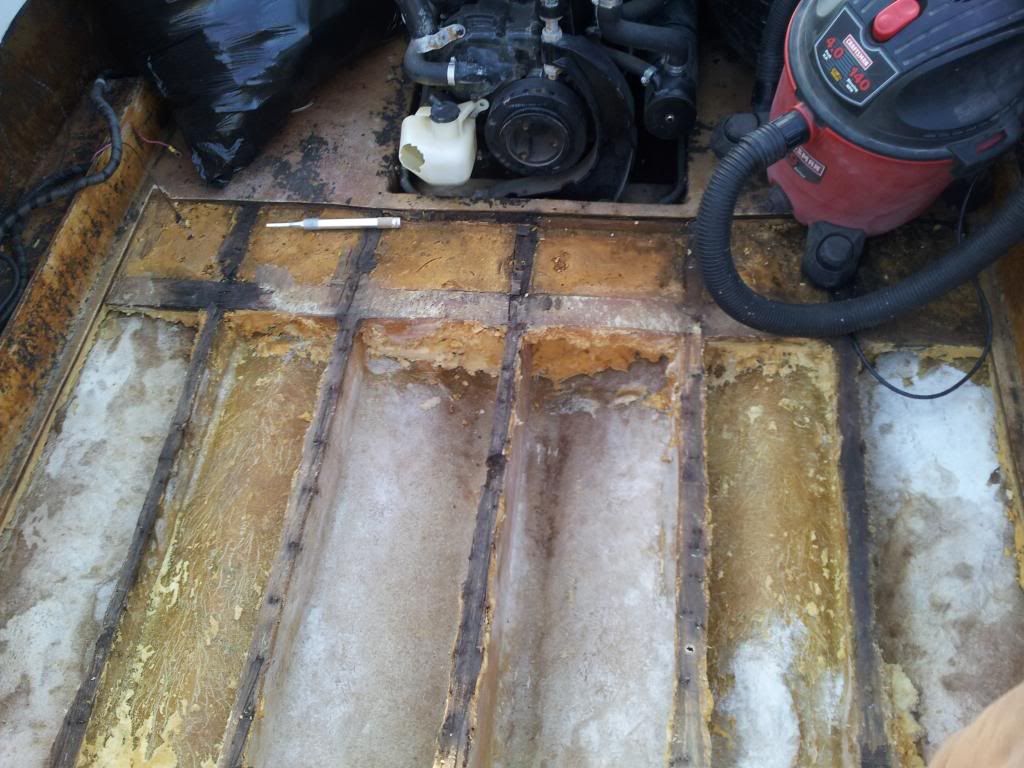

Currently it's on a roller trailer RR and I haven't ripped up the whole deck, there is still some decking about the motor and about 1 to 2 inches all around and some more in the front due to the odd shape. I really don't want to do a cap off and woodonglass said that's pretty standard for an I/O setup to leave the cap on. I don't forsee any issues with this and wouldn't it add a bit of stability?
I'm considering a cradle, but not quite sure how to get it off of the trailer and onto the cradle. I started reading oops' massive thread and got lost there for a few days. There are a few links I've seen, but haven't really looked into it further.
