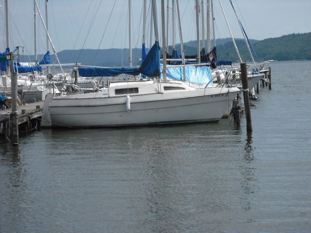

The picture in the water is where I found her.

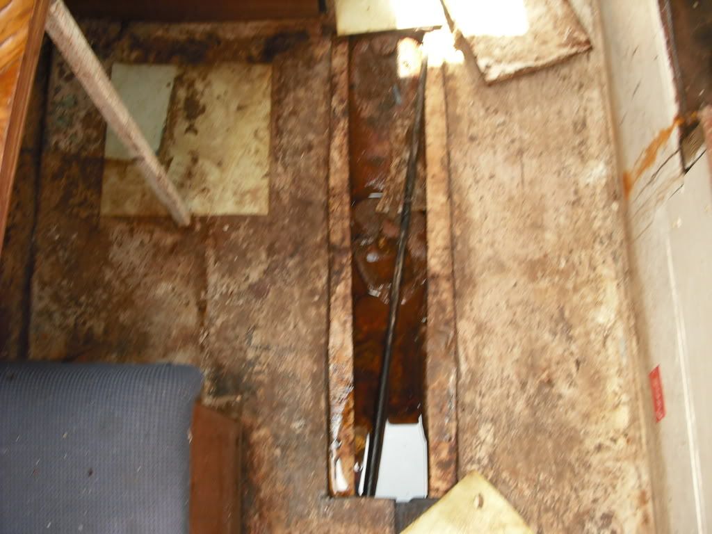

The picture of the floor is where I think is just rain water..

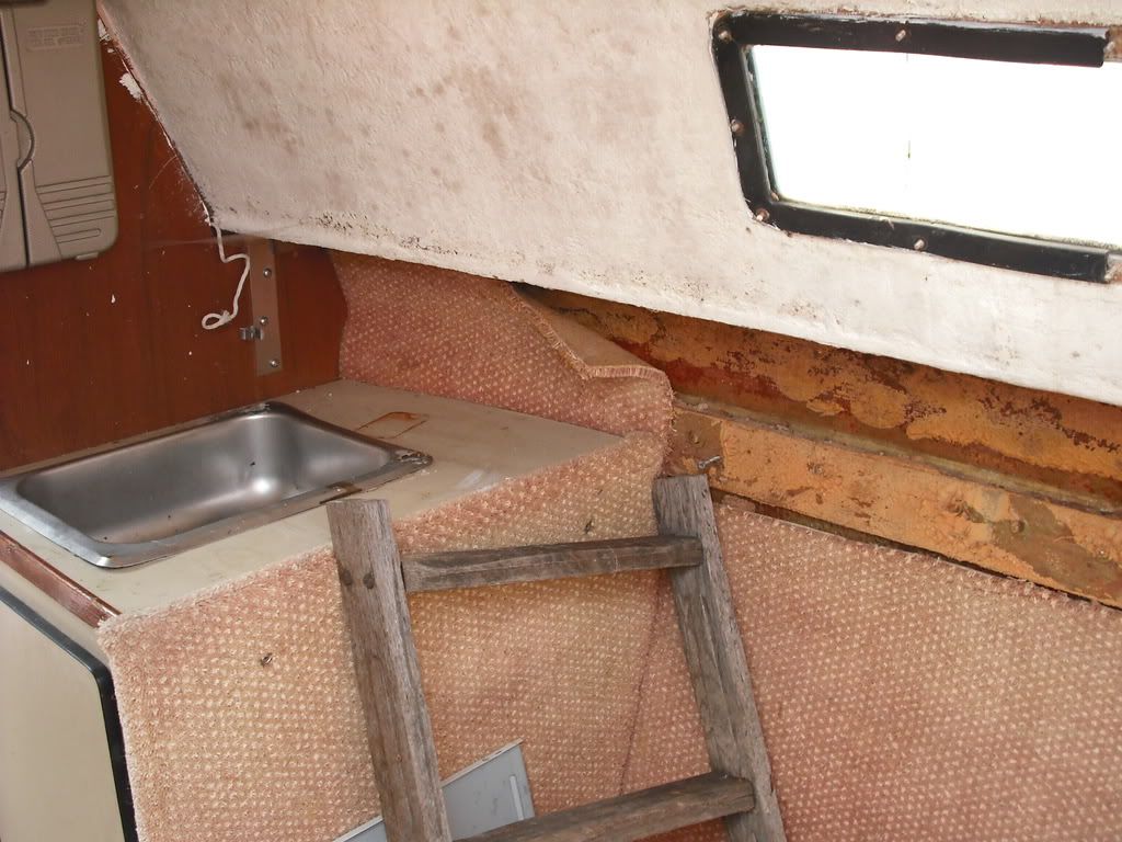

These were taken before she was pulled out of the water

man she is good size what 30 foot with a 10 foot beam ?John

Re: first restoration project
She is 21ft with 8 ft beam and the reason I bought her is 5'8" head room.
With a 5.5 hp Honda engine and free use of the stands and space at the marina for 6 months. I paid 1800.00 only thing is no trailer. Guntersville lake where she is at is a great sailing lake and a good place to learn how to sail after I finish repairs.
