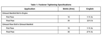

When you blow those pix up you see a lot of pitting, on the sealing surfaces. Remember that sealing surface is what keeps water out of the cyls. Usually you can't see the pitting until you get all the gasket material off and take a good close look. These surfaces should look like smooth shiny cast iron. I would either get them milled on a sanding machine or replace both the manifolds and elbows. If you get Barr Marine aftermarket for the Volvo the kit is about $750 for everything including new bolts & gaskets. Here's a pic of what these look like when new....I found that the casting of the Barr parts was very good, the paint was kind of thin so I'd paint them with a couple of coats of Rustoluim black they will stay rust free longer.

Look at Volvo's specs for the condition of the sealing surfaces...
Then their gaskets require the use of the copper based spray sealer...

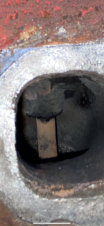

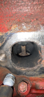

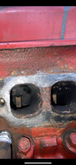

Thank you for all your input. Upon further reading, I think I’m going to replace the manifolds . I was so focused on the water passageways that I overlooked this item in the throat of the exhaust port. While I believe the water jackets are clear enough to circulate water, it appears to me that water may have entered the exhaust portion causing this sort of rust flaking on the partition. You can also see some extensive pitting on the exhaust throat and the flat surface ( the wall) above it is slightly thinner than all the other areas on top.
Would you agree that in photo one, that type of rust flaking would be caused by water intrusion? Or could that just be natural degradation? With all the reading I did, it seems like all the exhaust portions should just be black and sooty, but not rusty with flakes.

Yep we couldn't see that in the original pix due to shadows but for sure they were leaking and for sure replace the whole works. Your engine will appreciate it! This job if let go, will result in at least having to do a valve job in a season or 2. Rusty valve stems, rusty valve seats, low compression. BTW, take a good pic of your cyl heads where the exhaust ports are so we can see how your exhaust valves look....this is mine some years back see how the exhaust ports are grey/dark grey, no rust on the exhaust valves...this is what you want...the rust on the outside of the cyl head is just from the old gasket....

Whichever ones you buy take a look at the mating surfaces before installing. Some of the imported manifolds and elbows are not machined accurately enough to make a water proof seal. I used a straight edge and feeler gauges to check mine. Look at the Volvo Penta specs I posted in this thread. I would use OE VP gaskets and follow their instructions as far as sealer and torque specs.

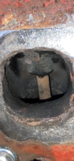

Got some photos of the exhaust ports. I’m hoping these valve stems and valves look normal for their age. The valve stems just have a very light oxidation that is on the surface but no pitting or measure rusting. It appears that the previous manifold gasket was not the right type and allowed some surface rust to form between the two middle exhaust ports. The Sierra gasket that I purchased for the new manifolds, have gasket material dividing these two exhaust ports.

I’m not really seeing a problem there except the engine may be running a bit rich or maybe burning a bit of oil. Looks like you caught it before any damage was done. Aren’t you glad you checked?
