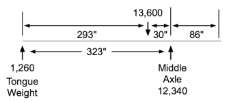

I took some measurements and this is what I came up with for balance point (referenced from the center axle)
13,600 lbs. total Weight . . .
So the balance point looks to be right over the forward axle.
Tongue weight is 9%.
EDIT: Corrected my diagram above.

That looks about where I'd expect the center of mass to be. More like an 80/20 split but lets face it... boats are a different animal and hard to get tongue weight with. I think you're fine.
Could always see where the trailer manufacturer wants the CM.
