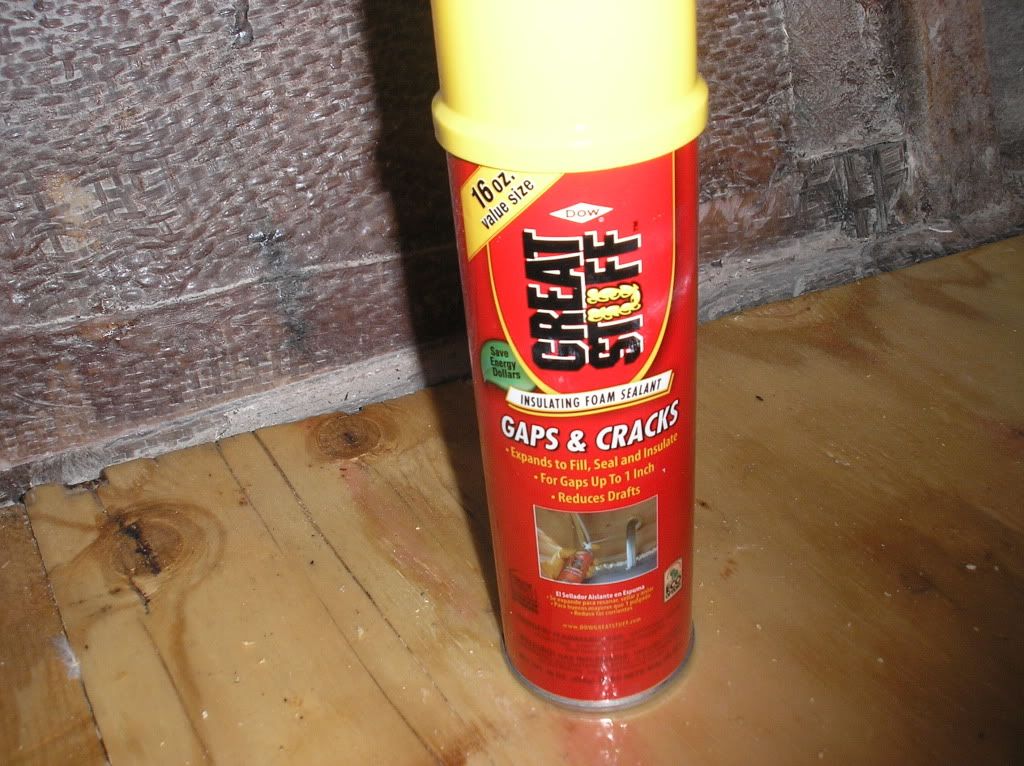

produceguy
Sep 30, 2010
1,243
Re: Foam Board question??
I used this to seal up some gaps in the deck and it will hold water. I had to cover it with pl and let dry and then glassed over it.
The good thing about it is that it did not dissolve with the resin.
All expanded foam will take water when pounded in a boat if held rigid, hydraulic pumping (hull pounding) will break it down.
Extruded foam (pink/blue board) is the least likely to allow water .
Blue extruded is denser and heavier, that might be better .
Great stuff is for draughts but mice love it too.;)
