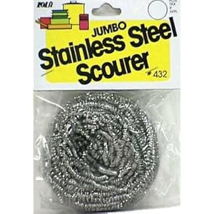

Here's the SS scouring pad I used, same stuff that was in the OEM Mercruiser oil cap. It was only a couple bucks at Walmart. Be careful with it as you don't want a piece of it breaking off and floating around the engine. It's pretty tough though, just a word of caution. If you are going to put some in the baffle, make sure to wire it in place, so it can't drop out. The rocker arms would have a field day shredding it, if it fell out.......
I picked up the 40W oil at Orielly's/Checker.
Oh yeah, you don't want to put it in the baffle tightly packed like it is in the scouring pad, pull it open so it has a lot of air holes.
