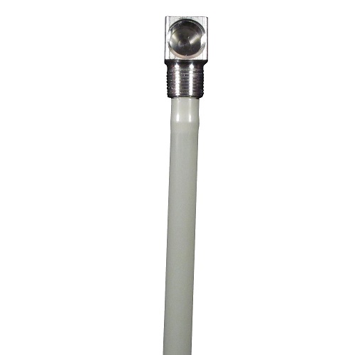

The pickup tube screws into the tank and the hose goes to the fuel pump inlet. Remove the anti-syphon valve and probe the 90 deg fitting with a small flexible item, weed wacker string,etc. If it goes in about 4 inches and stops, you found the hidden filter. Its inside that red box

This pic shows a filter mesh but it actually is inside the pickup tube, and the tube will unthread from the fitting
