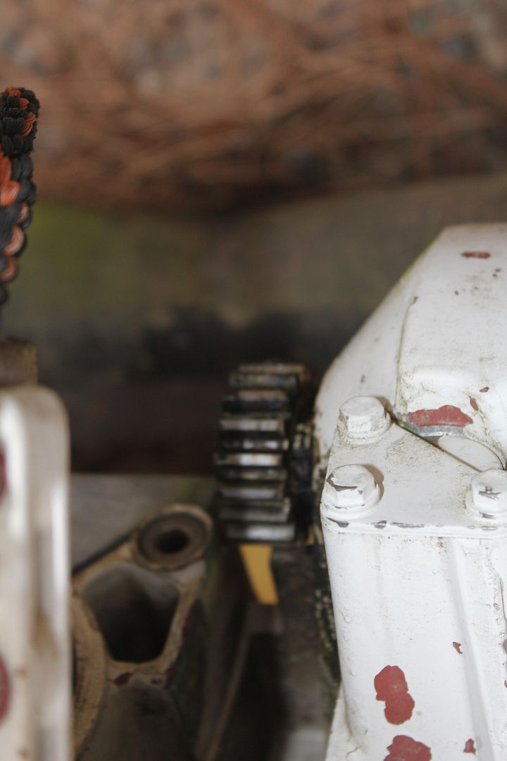

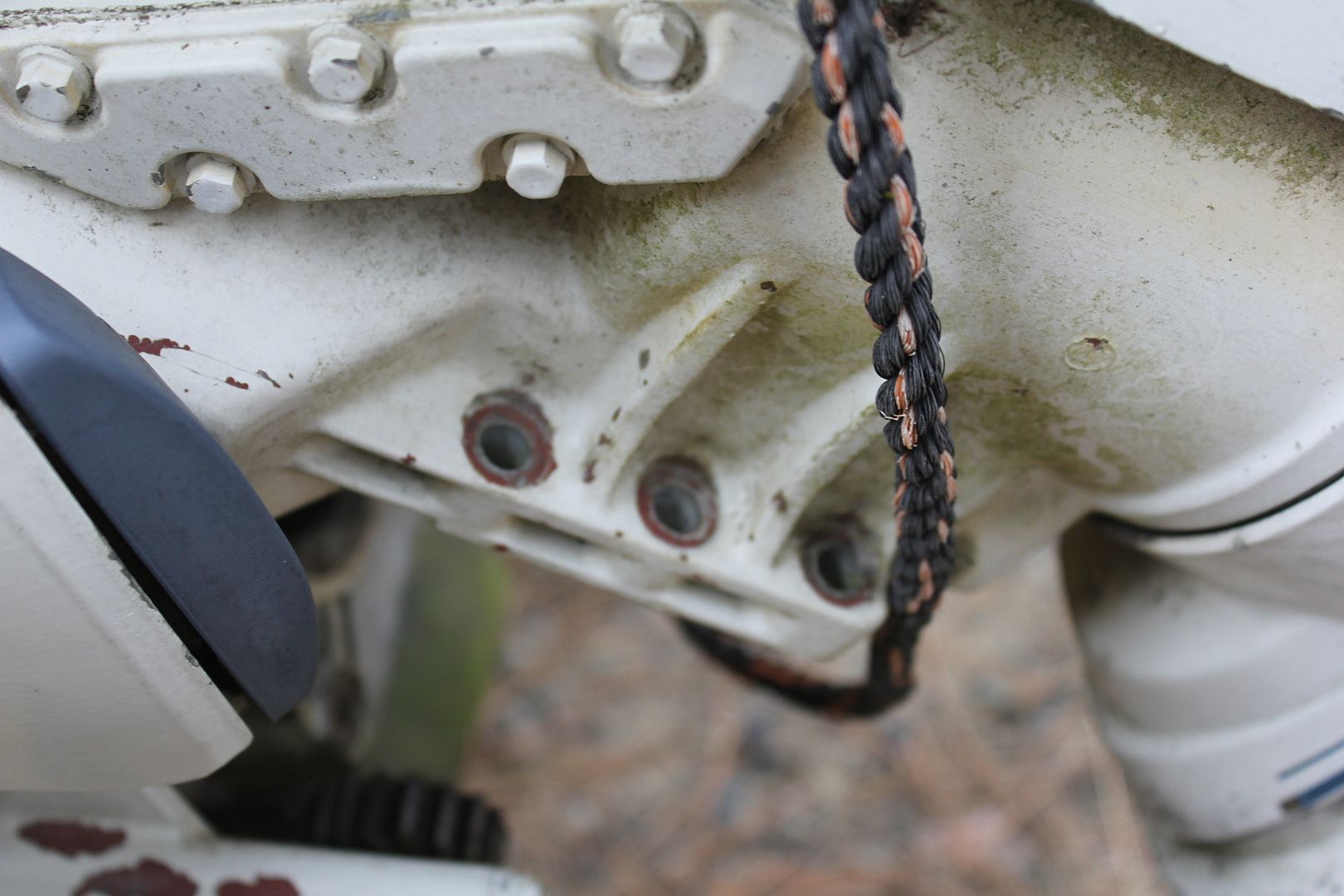

So I am a total newbie to the I/O world. The past boats I have owned were all outboards. I'm not 100% sure there is anything missing in my outdrive and have

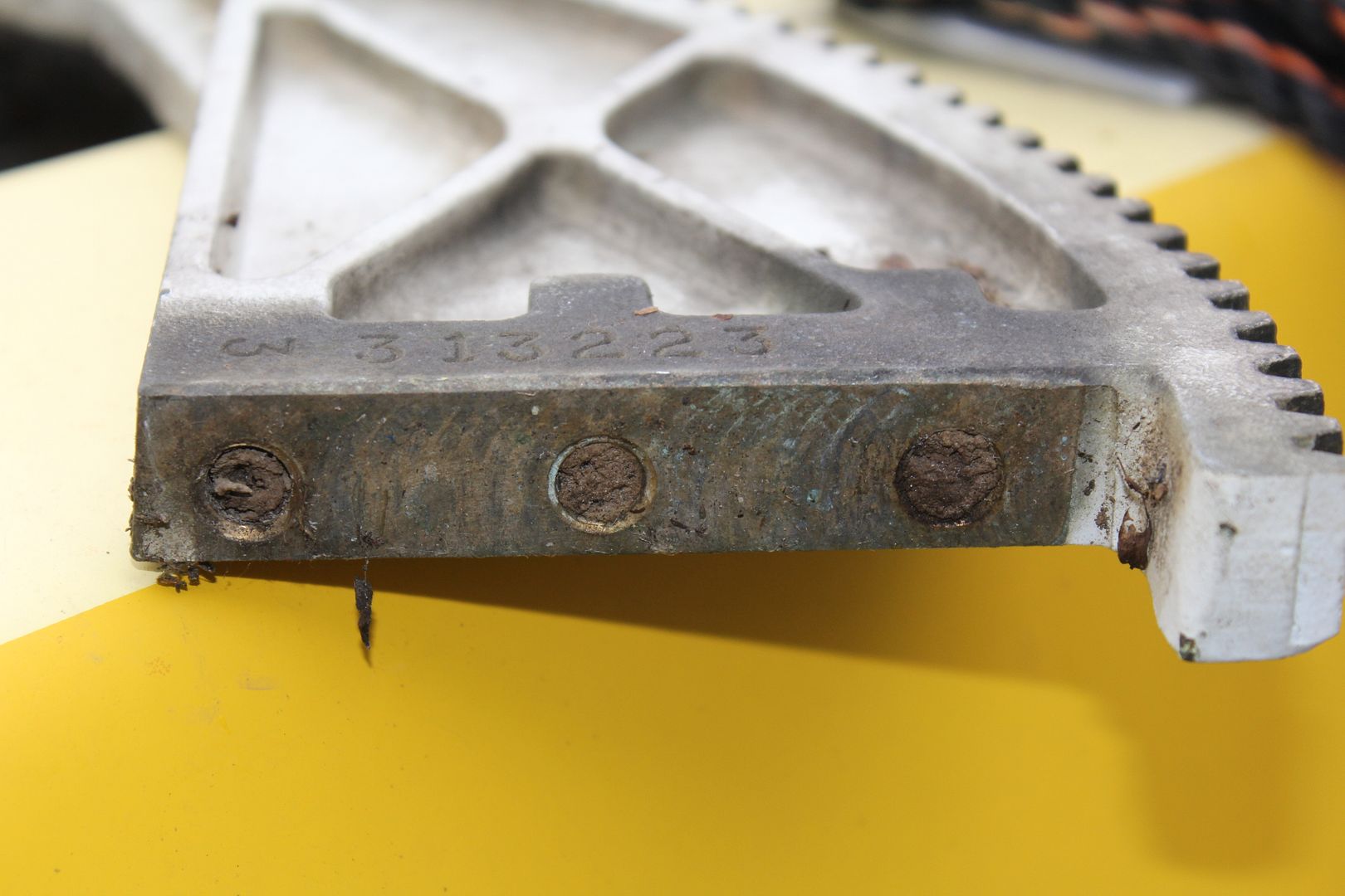

tried to look at as many exploded views as I can but it is hard to tell. The trim/tilt gear isn't installed right now because all the bolts are broken off in it right now. I am going to try taking it to my local machine shop and see if they can get the bolts out.

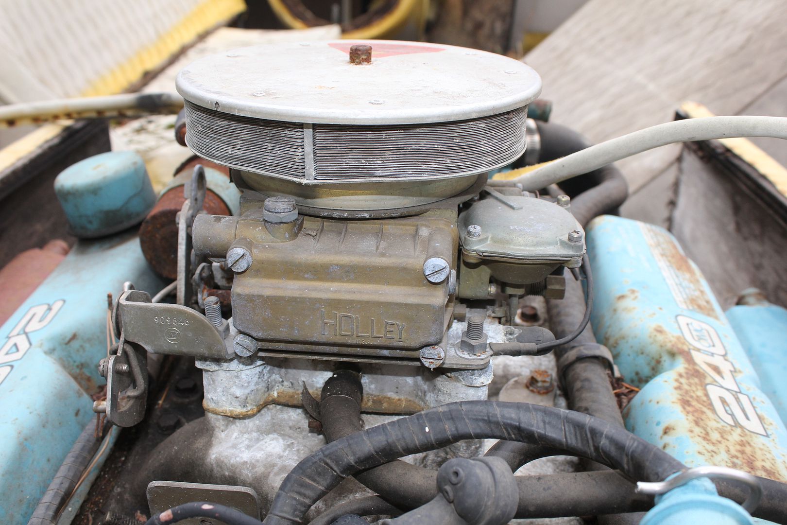

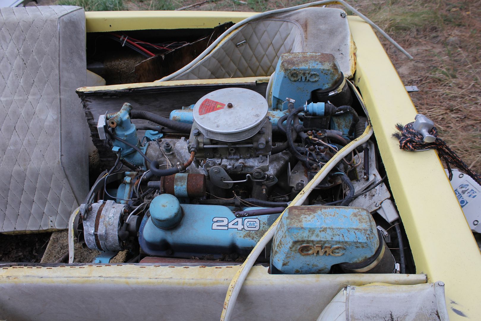

:welcome: That boat does have some sleek lines. Before you get to involved you should check the engine and drive. Step back a bit farther and take some pics of the out drive, and get a little closer and take some pics of the engine. That looks like and OMC stringer out drive. They are hard if not impossible to find some parts for as they are obsolete, and OMC has been out of business for nearly 14 years. That being said you may have an operable engine and drive so a resto isn't out of the question. Your gonna have some time and money into redoing the structure of that boat as well. If the interior needs that much work it's a sure bet the wood in the transom, and stringers are probably rotten too. If you have the patience she could be a real head turner. Read up on some of the completed boat projects and you will get an idea of what's in store. Good luck, and like I said check out the engine and out drive before you decide what to do next.

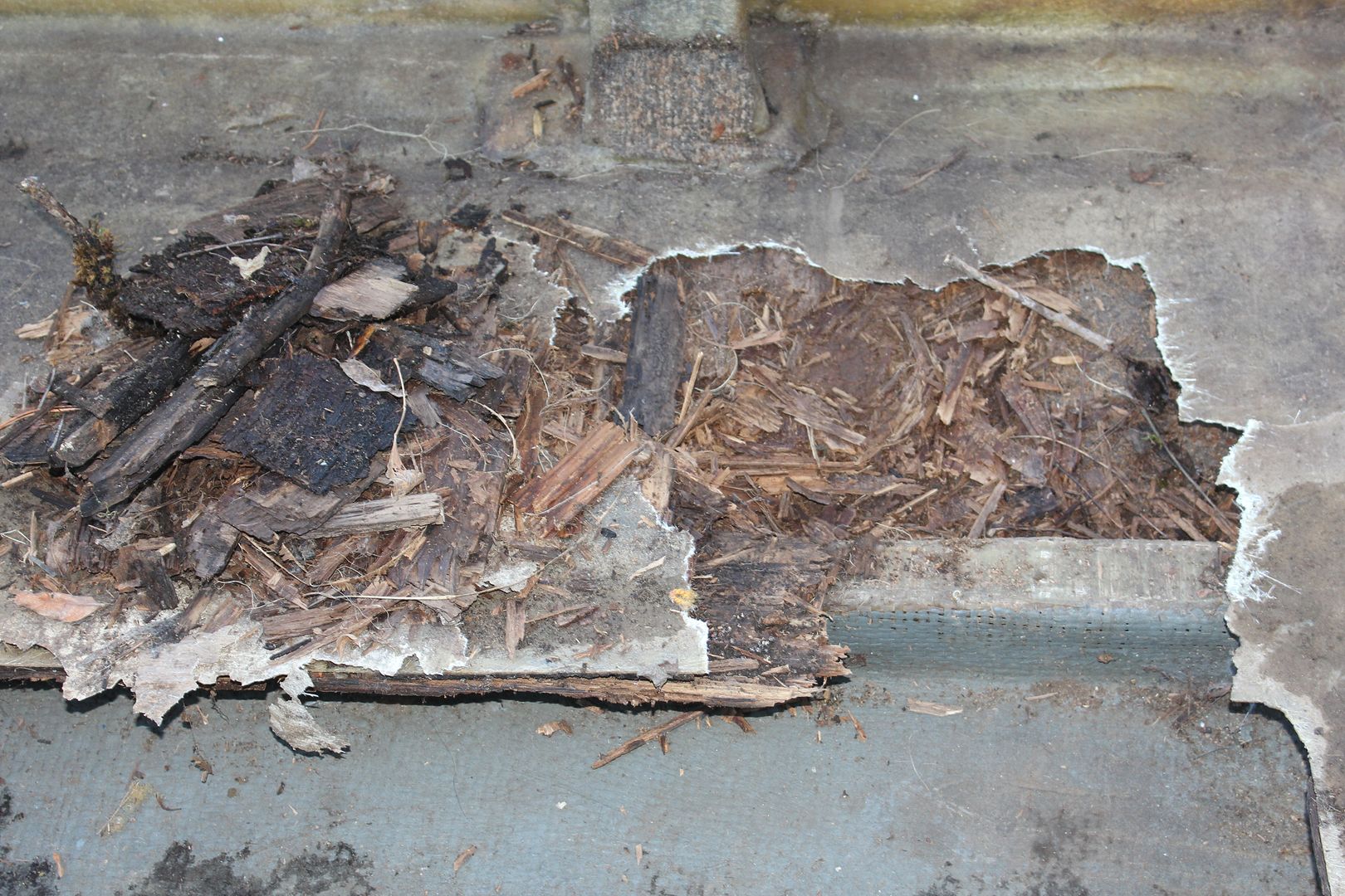

you've got a Hawaiian boat, not sure on the power and as said looking at the floor rot you probably have transom/stringer rot.
How far back would you like the pictures of the outdrive?
And what about the engine?

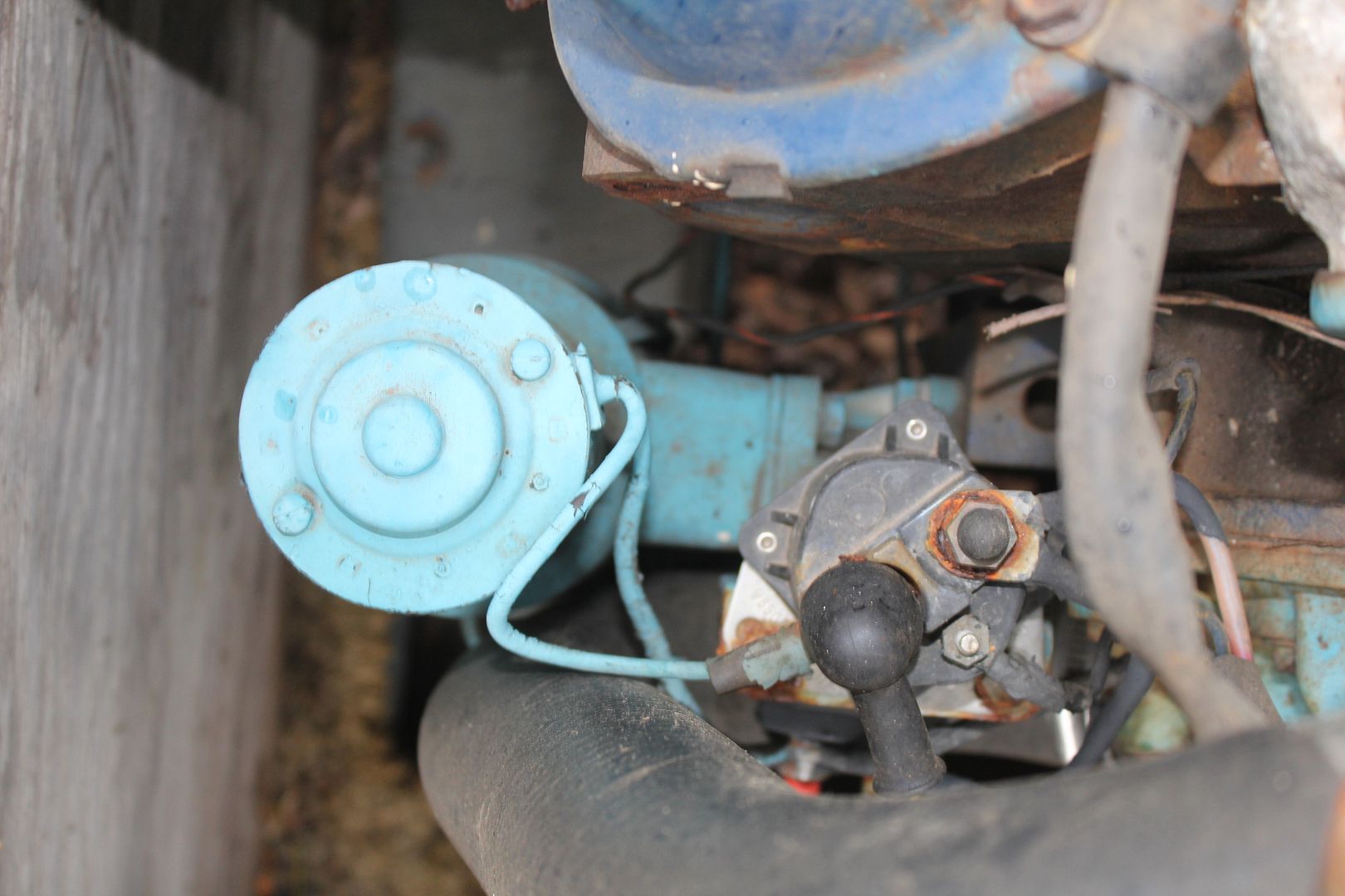

Can anyone tell me what this is and what it is for? It is on the left side of the engine looking at it from the front.
The engine is missing the distributor so one of the first things I need to do is change the oil in the engine. How do I drain the oil?

It does have a Edelbrock intake and Holly carb on it and there are Crane Cams stickers on the trailer fenders so who knows what has been done to it.

The thing you're trying to id is the trim pump. If the distributor has been out for a while and water has gotten in you definately could have major engine issues. It is an OMC and I think that is a stringer dtive. Before you get to into this restoration post your pics and questions on the engine and outdrive over in the OMC engine section. There are plenty of knowledgeable people over there who will chime in on what to do and where to go on your setup. Don't get to discouraged if you get abunch of people who tell you to run from this project. You don't have to much in it yet, and if you like her a repower may be worth the time and efort.

you do have a stringer drive, and I agree with redneckjoe, that with the distributor out, and especially by the look of thing down the hole, at best your looking at a complete motor tear down. I also agree on the floor, stringer, and transom observations. prior to interior, you need to focus on the structural aspects.
if you have all the paperwork, and are up for a restoration, we will be here to help.
based on the pictures, the intake is aftermarket, and from the looks of the carb with vacuum ports, the carb is an automotive carb. it appears to be an early 80's vintage based on the drive. the 240hp was oricinally a 350 chev motor. good news there, as if you need a different motor, SBC's are found everywhere.

Weight of the trailer should be on the title, however both my shoreland'r trailers weighed 1200#. The OMC stringer drive is the biggest issue. Parts are nearly impossible to find, and quite expensive when you do find them. If you have to redo the transom, you have a perfect opportunity to make the hole smaller and pick up a mercruiser or Volvo outdrive

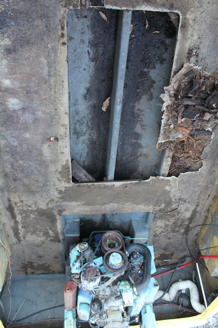

Well I got the interior all out of the boat. And Scott you're correct item# 14 is going to be very important to me. The floor is shot and has more soft spots than I care to talk about. I was really hoping it wasn't going to be like this.
So now it looks like I get to have the fun of pulling up all the old flooring and getting it ready to install a new floor. I can't say I totally understood everything I read but when it gets to be time to do all that work I'll be asking tons and tons of questions.

Now to add to the saga of my $400 boat I will have to try to rebuild the current engine or repower it with something else. So now the real question comes down to what do I want to? Here is what I found once I had everything out of my way.
So at some point this engine froze enough to pop this freeze plug plus the oil filter was blown off the engine. So if I get lucky the engine can be rebuilt but I ain't holding my breath.

if you like the boat, rebuild it. If you do not like the boat, then part it out and look for something that has not been neglected and sat outside.
regarding your motor, it appears to be rusted internally pretty bad. it would not even make a good core motor. you would be better off looking for a different motor at this point.
you are looking at about $1500-2000 for materials to get the hull and structure back to where is needs to be.
