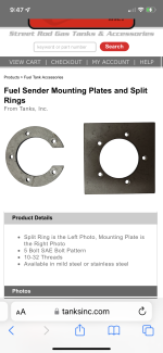

Looks like 10/32 is a standard thread for this application ?

Check out the pic - can I get away with that? Looks like all my new bolt holes would be very close to the edge of the 2" sender hole if I tried this. Would I get enough "bite" being so close to the edge? Is this where the metals being non ferrous come to my aid?
