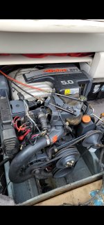

Post up pix of the engine & drive so we can see what you have. There were many variations in these and you have to know what you have to have a chance of fixing it right. 1993 was the end of the dog clutch Cobras but OMC made their own cone clutch model which is different from the joint venture models made with Volvo.

Yes EFI Model 50FAPRJVN 20260619_230521.jpgScreenshot_20260619_133034_Messenger.jpg
