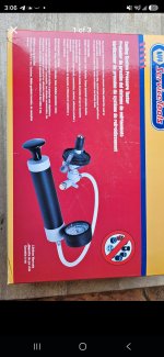

Is it something like this?

You basically have to disconnect the hoses for the exhaust manifolds at the manifolds and use a 3/4" adapter to connect those hoses together with the other ends still connected to the thermostat housing. Then disconnect the raw water inlet hose at the 'stat housing and make up an adapter that will allow you to pressurize the cooling passages.

Do I need to put the manifolds back on?

Sorry for all the questions. I'm going to pick up a cooling system tester now. Once I get it hooked up, am I listening for where the leak is coming from?

Sorry for all the questions. I'm going to pick up a cooling system tester now. Once I get it hooked up, am I listening for where the leak is coming from? And how much psi should I be putting in?
The exhaust ports of the cylinder heads, and also remove the oil fill cap, and listen there.
after doing the pressure test (12-15 psi) if it fails, I'd probably also try to hook up a smoke machine, like you use for checking out exhaust leaks and evap system leaks, it can make the leak a lot more obvious. I used one to fix 2 evap system leaks on my old Jeeps and also for an O2 sensor code, that is affected by exhaust leaks.

Thanks for all the help!
Just got it will report back with results.
What's the best case scenario?

I'm not sure if I have it hooked up right but it sounds like it's coming out from under the intake manifold. I hooked my tester into the hose off of the water filter I'm assuming it is. Pump air and I can hear it around under the manifold or maybe by the bell housing. Hard to tell.
