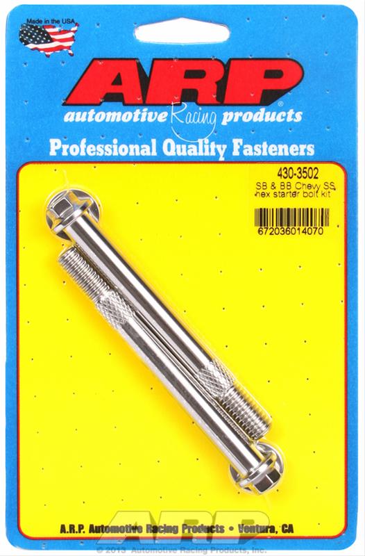

Thx guys! Good deduction. I will check this out when I get home. Do you happen to know what I could order today to properly replace this? I see alot of different starter bolts, none come with washers like these... a bit confused I am. And some have a rougher grove surface right before the threads, unlike mine.
Rick Stephens
Aug 13, 2013
6,118
Those particular bolts won't need to be marine sourced. Auto parts stores will have them when you identify the bolt that's missing and give them year GM motor.
