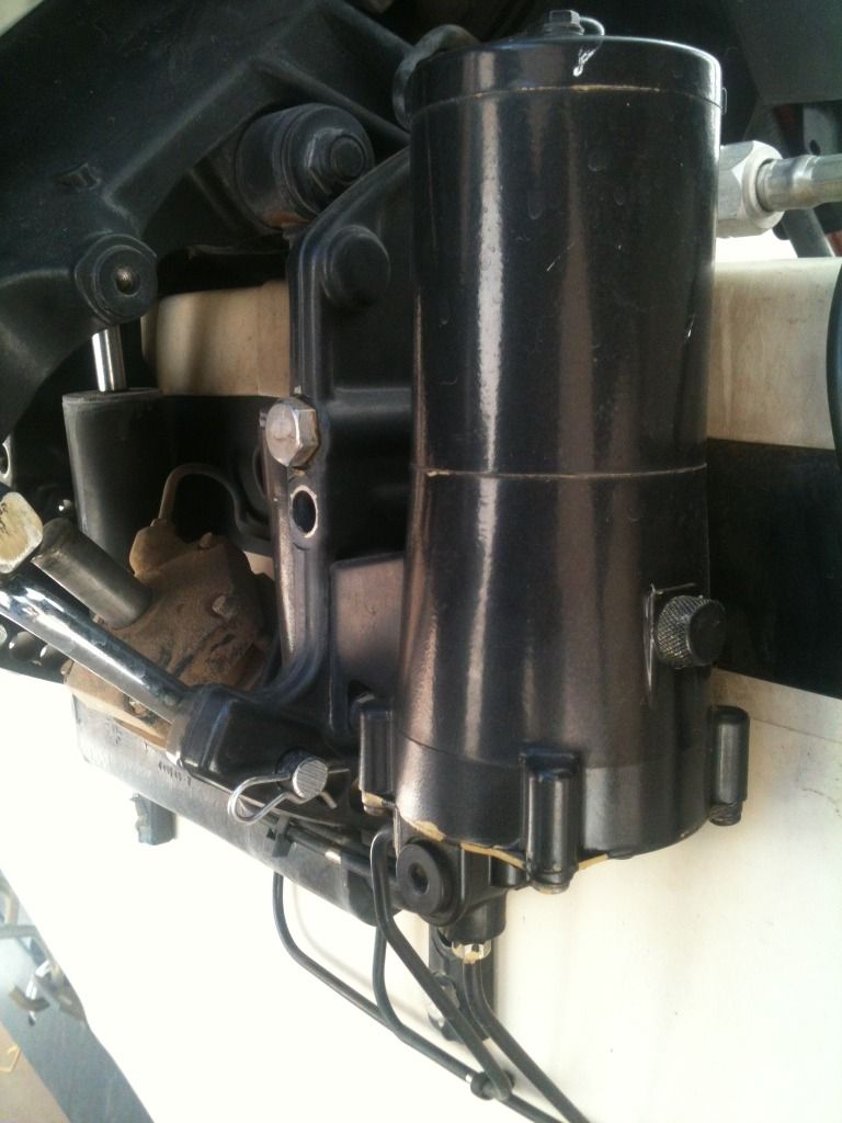

Hello Everyone,
The trim/tilt will not stay in the up position and seems to have a slow internal leak in the hydraulics. I would like to replace the faulty seal but am not sure if there is a write up on how to do it here. I tried searching, but the tilt motors i saw on here don't seem to be the same one i have. Here is i a pic of my tilt/trim motor
Does anyone sell a rebuild kit? Any tips?

Re: Help Identify issue with trim on 1991 Force 90 on my Maxum 1800
no kit. not user friendly repair. need new or rebuilt valve body. check ebay
90HP is just on the line of being okay with $90 chinese valve body. If you drive hard - like skiiing or pulling tubes then you may over stress it. Or if you have 25" shaft. But if you drive your 18' in a modest fashion then the chinese VB should go 3-5 years. I'm hesitant to say longer because last year the rubber seals on check valve plug were low grade. So even if you don't stress the soft metal you still have rubber seals that won't last as long. However, they fixed some of the stuff on trim motors from 2011 to 2012. So maybe they fixed some stuff on valve bodies too. I'll probably buy one of the chinese VB this spring just to take it apart and see if its fixed.
