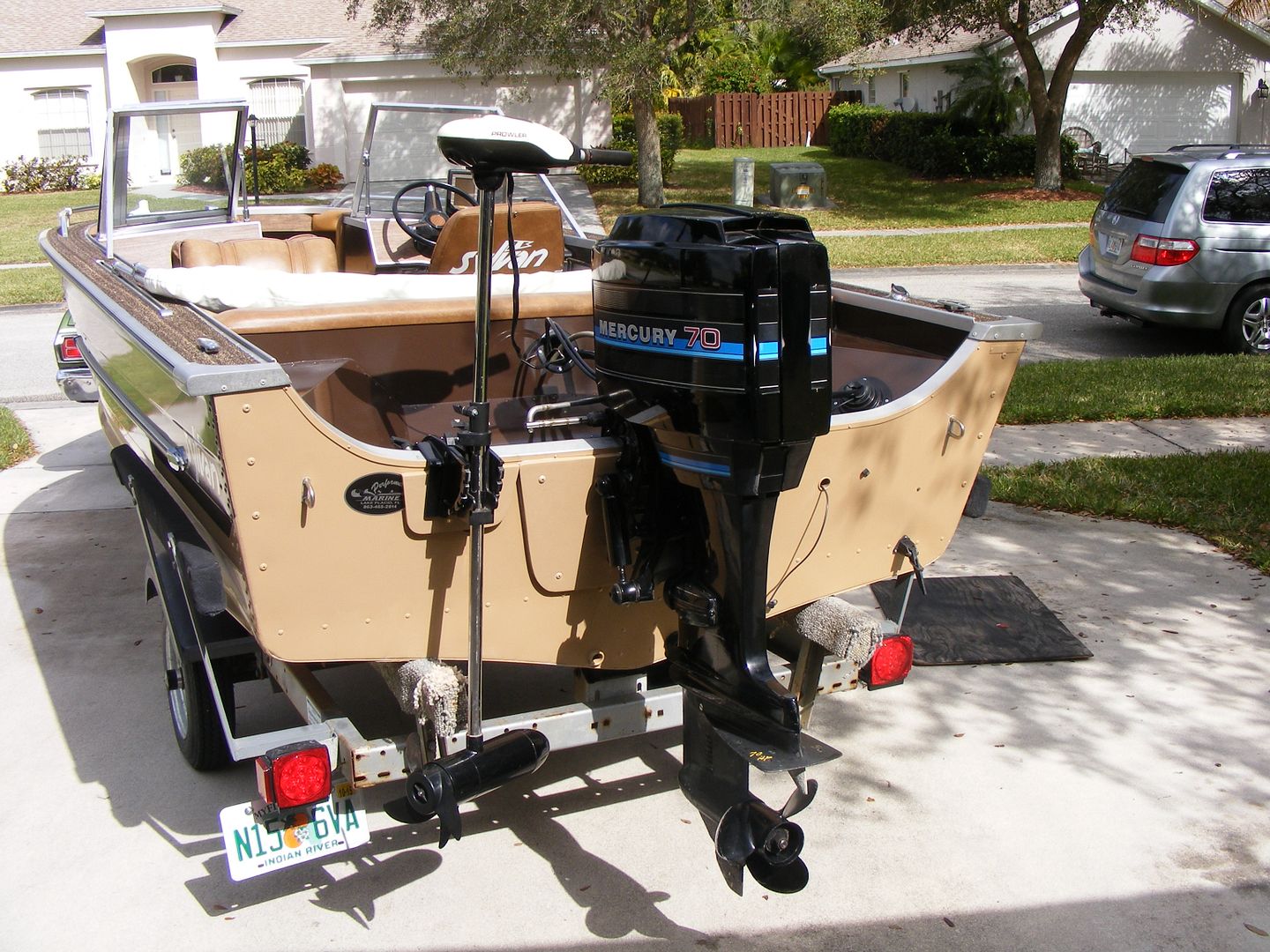

Hi guys,
I have a 1983 Sylvan Super Sportster 16V (StarCraft Super Sport), modified V, 5% or less deadrise at the transom. Boat weighs approximately 1,400lbs fully loaded with people and gear. It has a 1983 Mercury 70 3cyl (no power trim or tilt), with a 10-3/8 X 13 pitch aluminum propeller, Quicksiver, has small nicks on all three blades closest to hub and very little cupping on outer edges is present, very minimal wear/damage to blade tips, would rate prop at 90% to a new one, no vibrations. Engine is in excellent tune with recent spark plug change and is propped per the engine chart in the manual which suggested 29-35mph performance.
Holeshot and planes satisfactory and at full throttle will do 34mph (GPS) at 5750rpm when fully loaded. Cruises nicely at 3850 to 4,000rpm, around 18-20 knots. Boat operates satisfactory and am tempted to buy a new Quicksilver prop and use the old one as a spare, boat works ok as is but there must be room for improvement.
Only issues are the prop occasionally ventilates or breaks loose momentarily when crossing wakes or if there is allot of wind. Nothing bad but would require manually moving engine down one notch to prevent it which usually causes it to plant the bow down a bit more than we would like. From what I have read so far, an aggressively cupped prop might reduce this.
Because of the manual tilt deal we sometimes get a little close to the bottom when looking for a place to anchor, manually lifting is a pain so sometimes we kick up a little sand, not enough to really damage anything at idle but it seems like a good idea to have a stainless prop for a little more abrasion protection and hopefully pick up some economy/performance with the thinner blades.

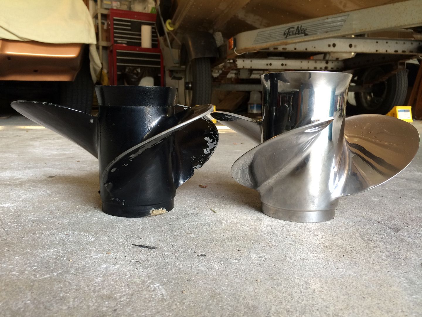

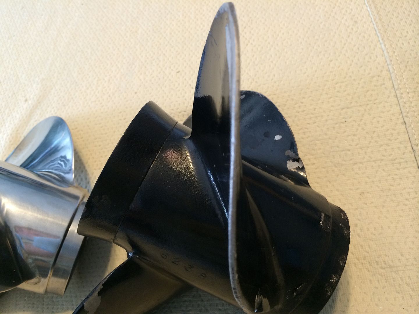

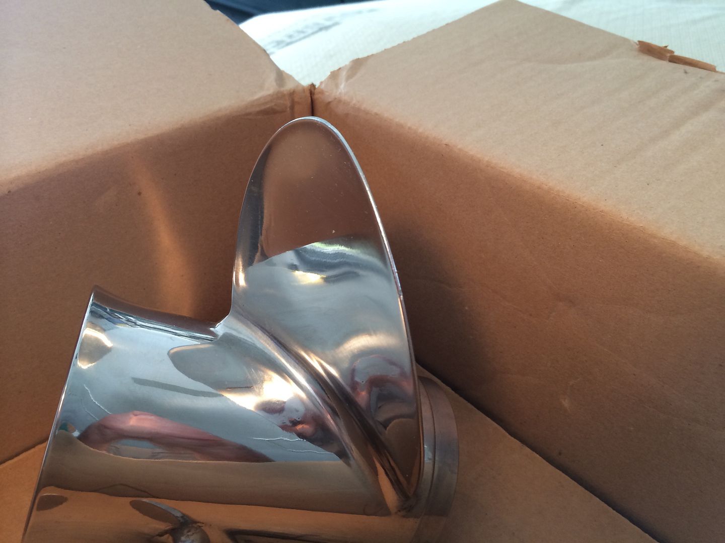

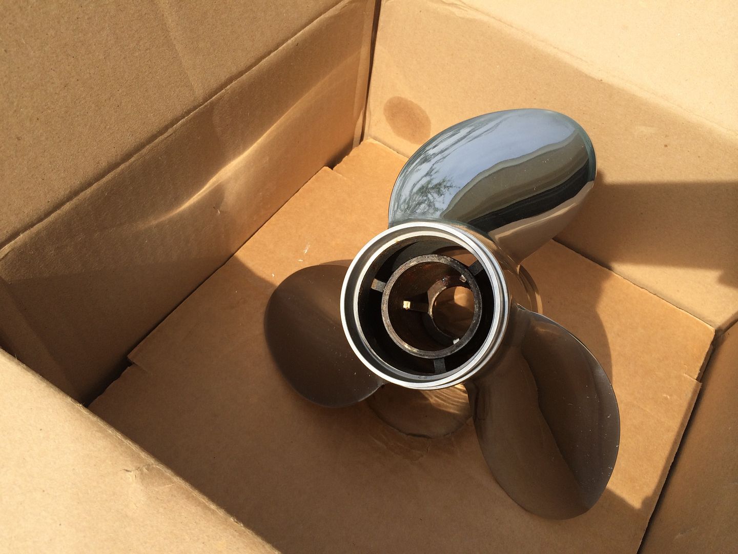

Ok, I picked up a Stiletto Triad model 802313 (Same as Turbo Hot Shot-Precision Propellers) 10-1/2 x 13 SST prop.

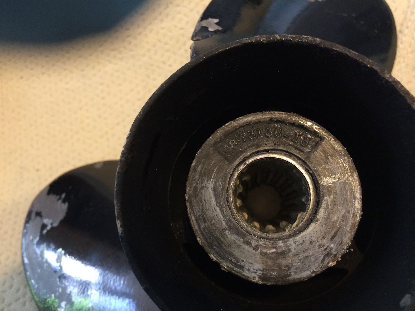

It replaces my quicksilver 10-3/8 x 13 aluminum prop

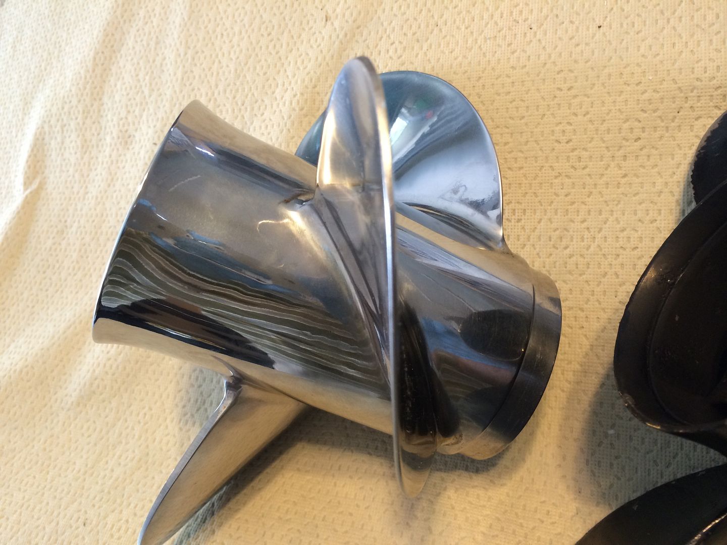

Thinner Blades, better cupping and slightly larger in diameter with a longer exhaust barrel

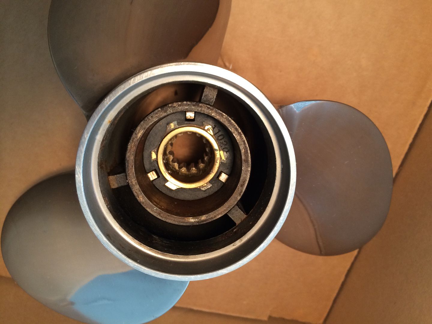

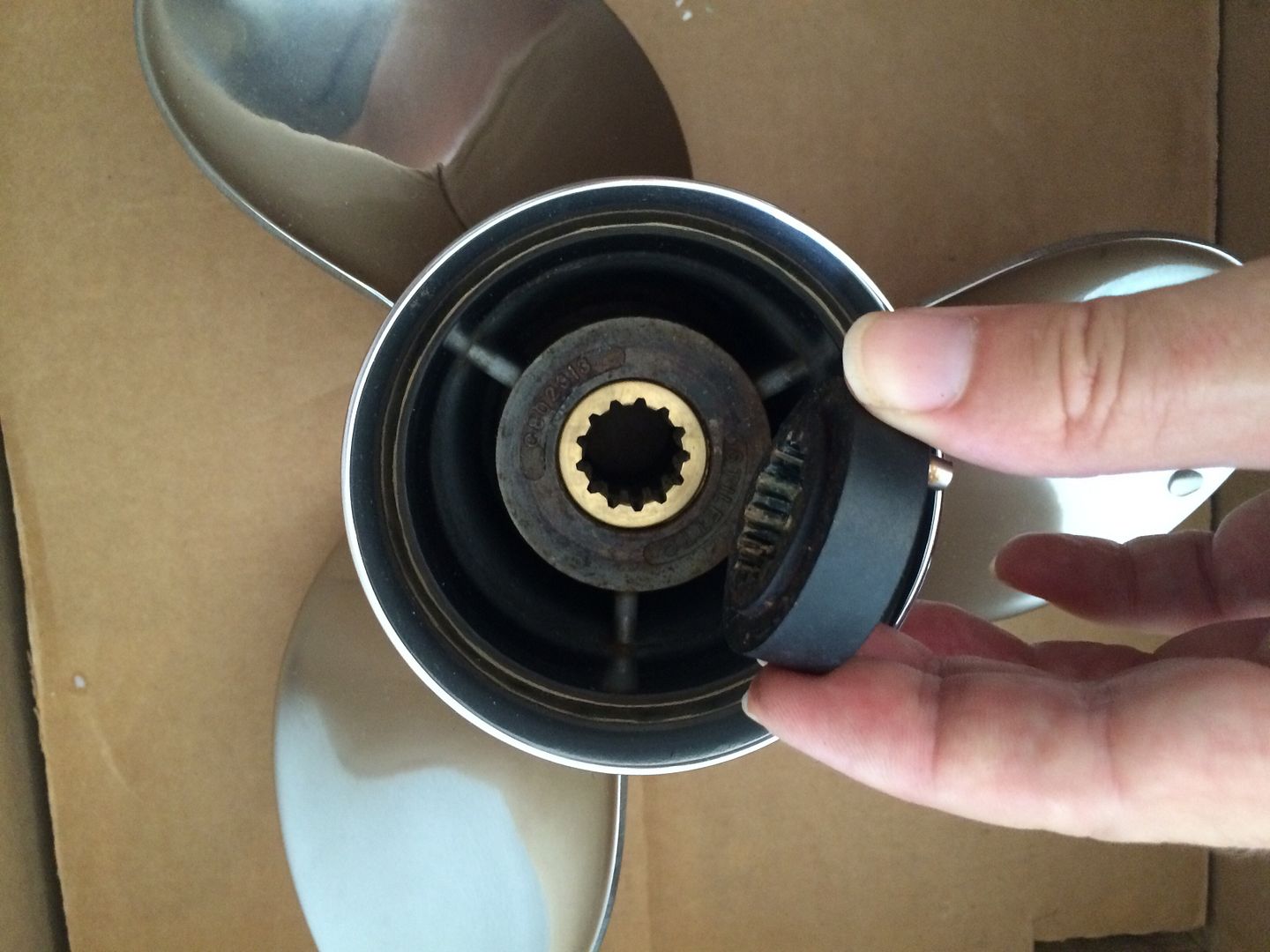

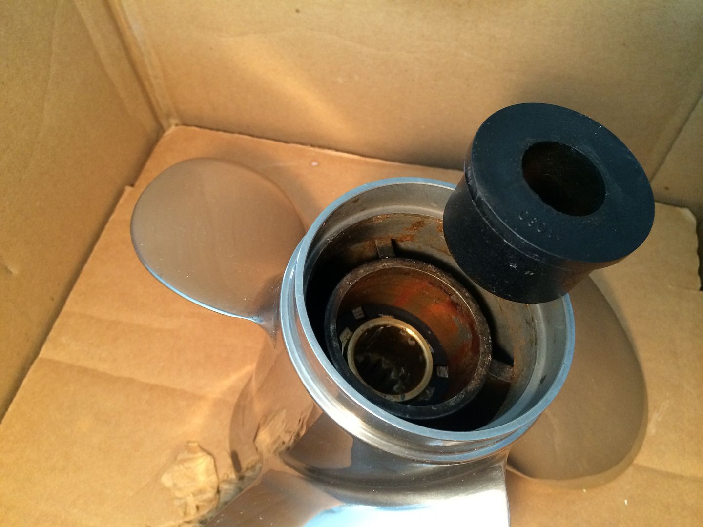

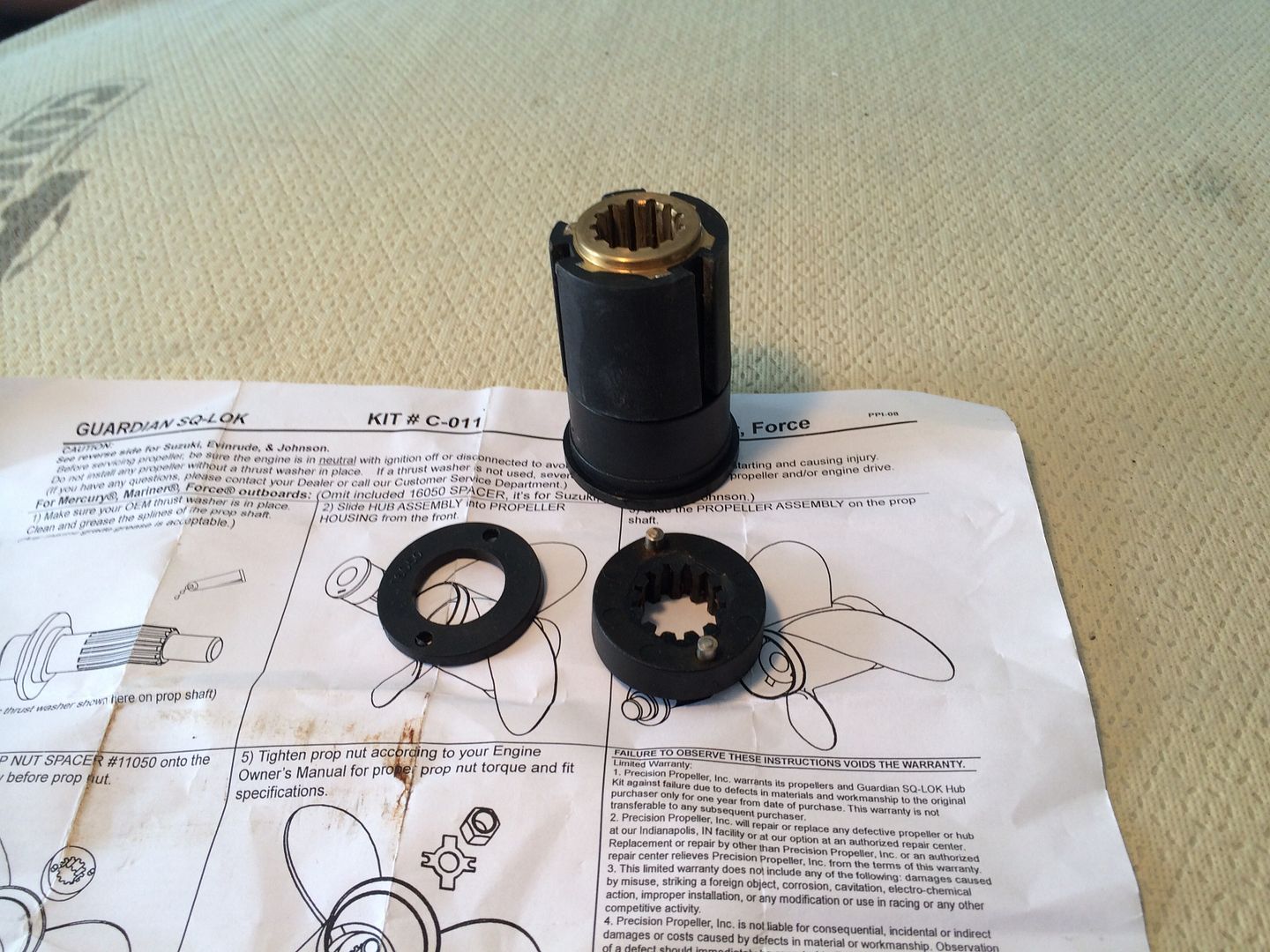

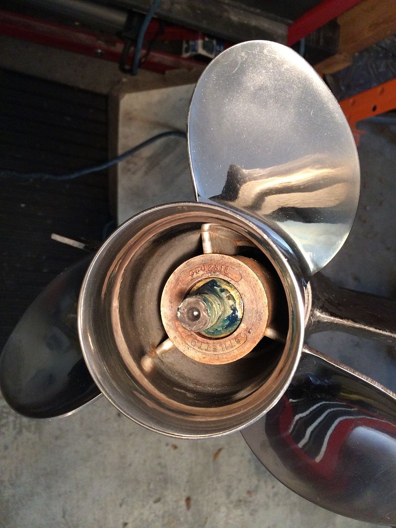

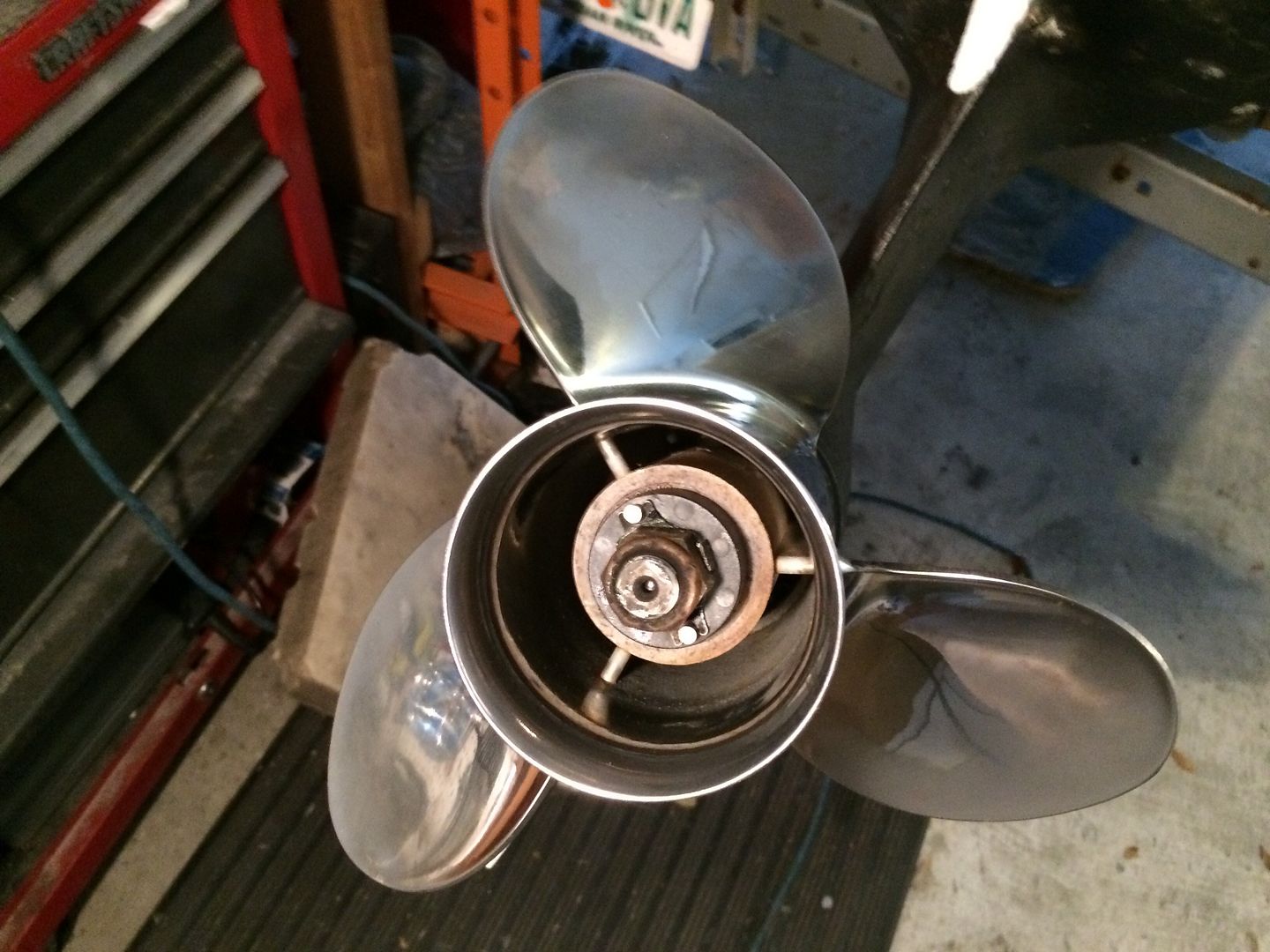

It has the odd style hub isolator with three notches to hold the torque, it has plastic aft nut which I wasn't real fly with, also this means rubex and flo-torque will not interchange:
The black washer with the two holes in it is not used on the Mercury install-Kit fits Suzuki-Yamaha too.
Prop self centers on the brass spline tube protruding from plastic isolator
If this aft washer cracks it looks like the metal aft washer from the rubex kit would work. I actually got an extra hub with purchase because previous owner cracked first aft washer when attempting to torque to 55ft lbs per manufacturer specs. I torqued mine to 30 and then moved until I could engage lock tabs.

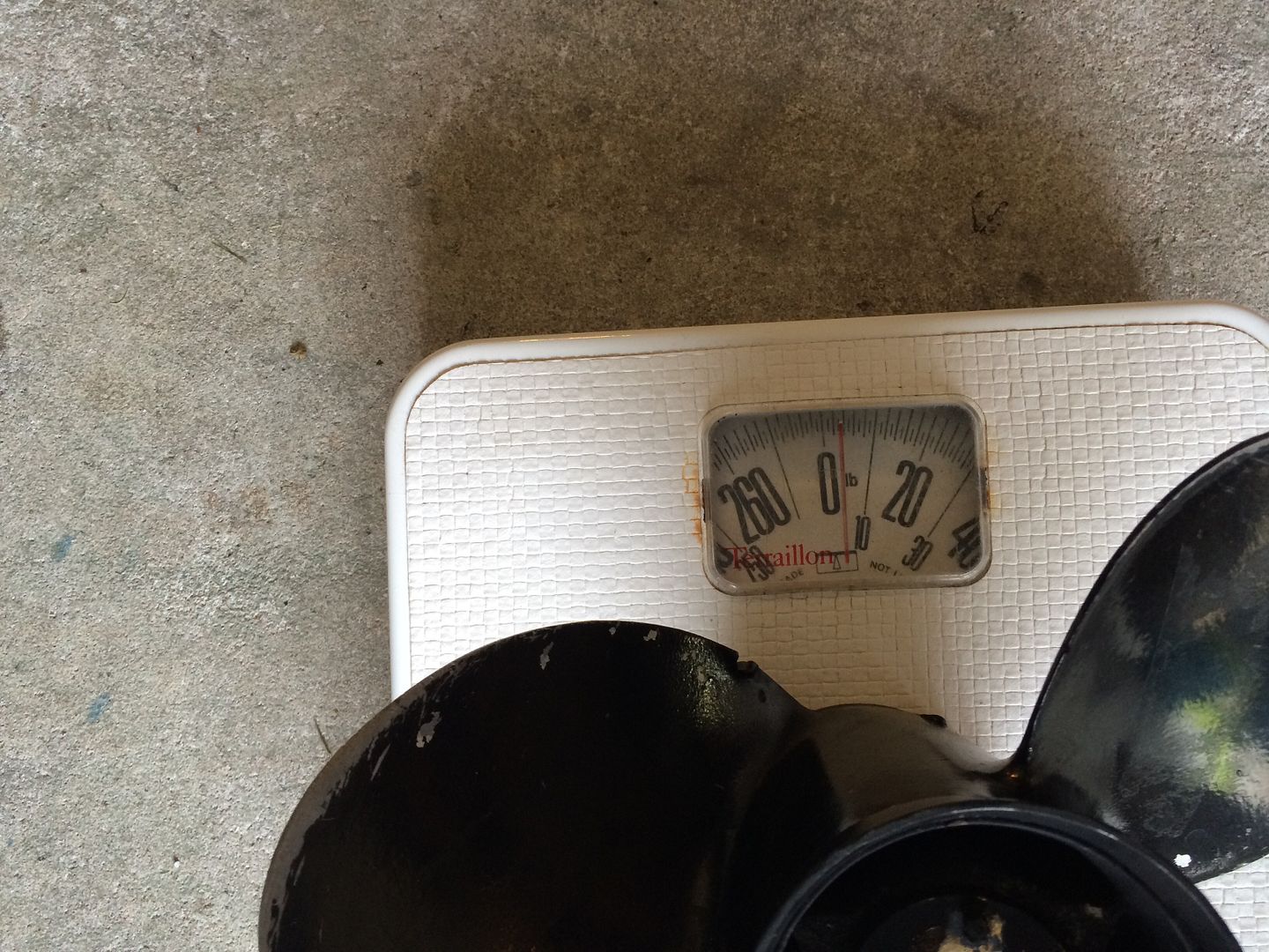

The quicksilver weighs around 3lbs, about half the weight of the Stiletto.
My prediction: Prop will lose maybe 150 rpm's and gain 2-3mph top speed with less ventilation.

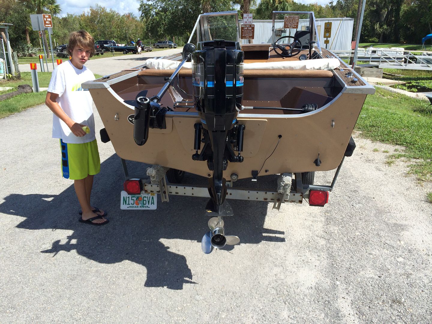

Ok, we took it out this morning and here is what happened:
35-1/2MPH was our best speed, 5600RPM, so we lost about 150RPM and gained about 1-1/2 mph. At 4,000rpm we go 23-24mph, about 1-2mph faster than before. Boat does come out of the water a tad more(bow and stern) and seemed to do much butter in the chop after the wind picked up. Ventilating has been greatly reduced at same engine height setting. Over all very happy with my shot in the dark on this one. Also, prop engagement is still smooth in spite of nearly doubling the weight of the prop. Happy Camper!
