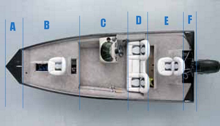

Hello people!
I am learning quickly, but am falling short on terminology.
I have learned that the cap is the top of the boat that rests on the hull.
But, for instance, I have damage in the floor area between the steering wheel and the storage/seat.
The issue is, is that I prefer to speak knowledgeably when talking to people.
So, I am adding a picture of a top view of a bass boat, and would like to know if there is a way to say where damage or issues are on the Cap, utilizing proper terminology.
Here you go! Any help would be amazingly appreciated!!
Small Saddle Wedgie
Feb 8, 2014
42
Re: Help with terminology
For instance:
I have a hole and water damage in section C.
I would like to say I have water damage and a hole down in the ________.

'Floor' or 'cockpit sole' would be reasonable terminology. Others may have some additional terms.
Not a good place to have a hole as that leads to the structural areas of the hull. So, water can (and perhaps has) accumulate in the hull and rot out the structure (if it is wood).

Ayuh,.... To carry on JB's teachin's,....
Boats, don't have Floors,.... they have Decks,.... ;)
'n for the record, that boat don't have a Cap,.... it's an open hull, with decks,...
A forward castin' Deck,....
The cockpit sole, 'n an aft castin' Deck,....

As Tpenfield said, "cockpit sole" would be the most correct.
And, .. agreed, boats don't have "caps". That may be a term used here, but it is not correct.
Boats can have "floors", but they have nothing to do with the surface you walk on. "Floors" are a framing member that ties the frames together across the top of the keel (not typically on a plastic boat).

OK question: The top molded portion of the boat is referred to as a cap. Normally refers to closed bow, gunwales, splashwell etc. My Dual Console has seats and a deck molded into the cap. Obviously you walk on that deck and sit in the bow seats. Is that a Bow Sole?
Small Saddle Wedgie
Feb 8, 2014
42
Chris, that was my understanding. The Deck is under the cap.
So when I'm standing on the bow (forward casting deck), I am actually standing on a fiberglass Cap, which is covering a wood deck.
The 'Open Hull with Decks' would be an apt description.. except there's a solid fiberglass 'Cap' that covers everything.
(As I have recently found, because i am going to have to tear this boat apart to fix her!)
I think I have comfortably determined what to call everything, but it's real interesting to see how terminology varies, and how even though they might be a little different, it's pretty easy to get your point across :)

Ok, so thinking more about it I might suppose that given today's modern manufacturing techniques the term "cap" could/would be applied to the unitized assembly of components that is traditionally made up of separately named parts (as it is referred to here), though I don't know if the term is used in the business (of building boats). ( I have only worked in building steel and more traditionally built boats).
I would still call it the 'sole'
