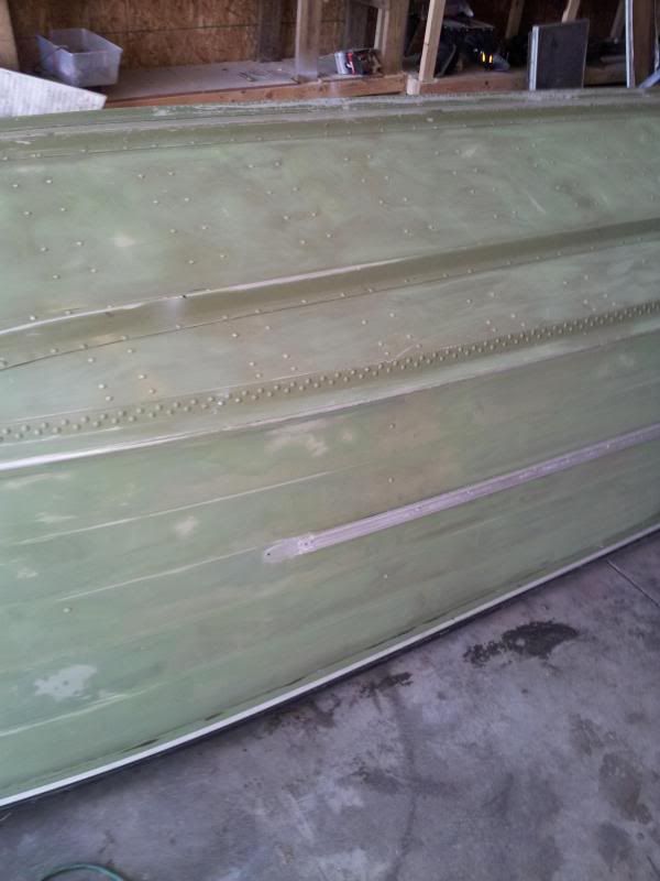

Here we go, the laborious part that I hate sanding. Its hard to remember that the whole quality of a paint job is based entirely on the prep work we all know the drill feather all knicks dings dents and scratches if you can feel them with your hand you will see them in the paint.
The worst part is where the stickers were.
The paint on this one is in way worse shape than my 18' the hull is in decent shape though.
I am going to save money this time, I am going to buy self etching primer by the quart I am going to do the whole hull in it and then shoot it all with high build primer after. I can get a quart for about $20 locally or I will buy the rattle cans for about $8 each.

The hull looks fairly ding-free, Sig.
classiccat
Dec 20, 2010
3,412
Re: Here we go with the 16ss
Looks like you're on/ahead of schedule (and budget) Sig!
That's some nice-tin; she'll clean-up beautifully!

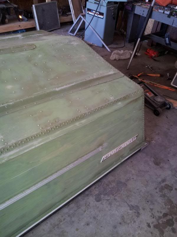

More sanding today, almost done, got bored with the sanding. Started getting the shop ready to throw some paint.
I mean lets be honest with ourselves here. I haven't actually scrubbed the shop floors since ohhhh right before I painted the 18'SS and its in no condition to paint.

Well Jb I view it this way, 1/2 of a good looking paint job is in the prep work, 1/4 of the job is the environment and equipment used to lay the paint, and the other 1/4 is actually laying the paint, so I am just counting this as paint work time.
I guess technically since I did some sanding, and I pulled the rubrail insert and rubrail today, I did do some boat work.
I finally beat my rubrail demons, and got both sides out without breaking any of it.
