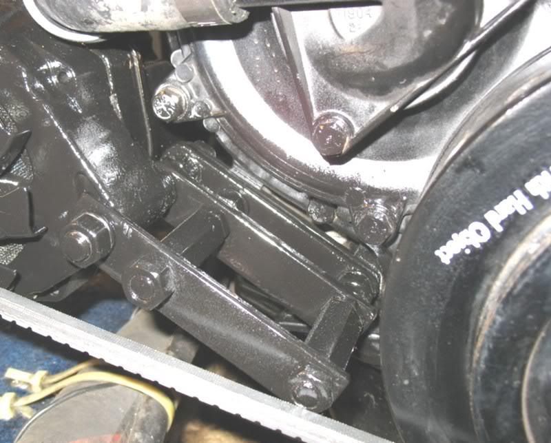

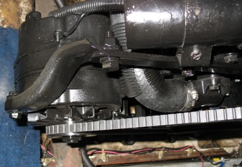

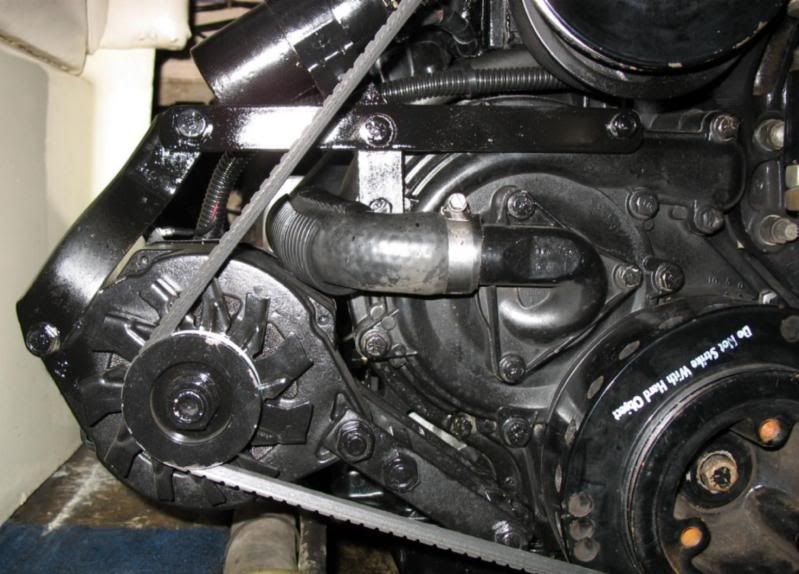

http://img.photobucket.com/albums/v209/guyaverage/boat024.jpg
http://img.photobucket.com/albums/v209/guyaverage/bracket.jpg
http://img.photobucket.com/albums/v209/guyaverage/boat026.jpg
Here are some pictures of my homemade 'low mount' setup. It relies on the power steering pump for adjustment of the belt tension. There are two 7/16 holes under the water pump housing that in some 470's is used to secure the bracket for the coolant overflow tank. I moved the overflow tank to the transom, and put threaded rod into these holes. The supports are 1/4 inch thick, 1.0 inch wide steel straight out of Home Depot. I used rod joiners between the lower supports to stiffen the threaded rod.
The upper support beam is the same 1/4 x 1 inch steel as the lower support, attached with 5/16 threaded rod into the water pump housing. The curved bracket on the top of the alternator is off a Chevy S-10, it gave the perfect spacing between the upper beam and the alternator, in order to line up the pulleys.
Since everything was threaded into aluminum I was a bit conservative with the torque wrench and used lockwashers wherever I could. It looks a bit cheesy, but whole assembly is very solid and doesnt vibrate at all. Once everythig was cut to size and fitted, I cleaned the individual parts with acetone and sprayed it with rustoleum black.
