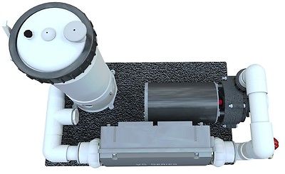

since it don't work now, no harm in pulling the whole spa pack out and seeing what you can do with it, since you say there is silicone everywhere may as well pull it out and put it back right. 20 years ago I was a pump tech at chemical pools down in cocoa beach fl, I have seen a lot of rigged up messes, when I showed up at a job and it was half ***** rigged up, 1st thing I did was pull that mess out and start new. its not hard to work on, make it like you want it, add those shut off valves, then next time you can close it off and pull it out to work on

^ yup, that's exactly what my plan is, although its not a typical 'spa pack' set up.. Motor and pump are one unit, control box (balboa?) is mounted separately... but i can get to it, its just a pain (already had it out to hardwire motor..) The way i figure it is IF all the lines are good and didn't explode, I'll have a new pump, motor,and good conections/shut offs in place if i need to service in the future. If some lines blew, then the thing is scrap.. but I'll have a better chance of selling off a NEW motor/pump and get some of my money out of it.. if it gets above -15 in the next few day Ill try to yank it out so I can further disassemble and make some decisions, on the WARM workbench.. :)
