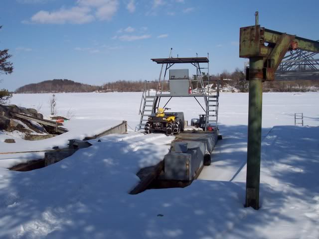

Ayuh,.... Actually, the shape of the hull has alot, if not everything, to do with whether a hull can be left to freeze in, or not,...
My tin barge, a Starcraft Islander, has a hard chine runnin' the length of the hull, outside corner,...
That chine would lock the hull into the ice, 'n probably crush it,....
This barge We built 15 or so years ago, outa big ole propane tanks, has been in the St. Lawrence river ever since We finished her up, year in, year out,...
Bein' all rounded below the waterline, when the ice gets thicker, 'n bigger, the barge just rides up onto the ice,...
We knew this was gonna be the way it lives, so We also build a hyd. transom for her outboards,...
In the fall/ early winter, the outboards get lifted up, 'n completely outa the water,...
The outboards were bein' replaced when this picture was taken, but you can see the hyd. rams that lift the moveable transom,...

great pics Bondo!! unless constructed to deal with ice pressures,,, ice and boats = bad things..... u walk out there and poke a few holes in the ice? fish?
