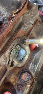

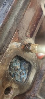

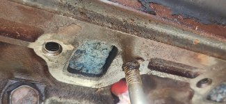

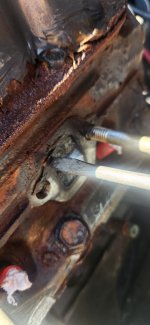

I was able to get all the gasket material off the engine block. Here was the method:
1) Vacuum all around the exhaust and the spark plug holes
2) Use the vacuum as a blower and blow out any debris
3) Block the exhaust ports with sponges cut to size
4) Block the spark plug holes with tubing and rags
5) Soak the gasket with PB Blaster Rust Remover (I'm not sure if it worked better than Gasket Remover spray)
6) Use a combination of: plastic scrappers, metal putty knives, Razors with a short holder, and a razor with a 5 inch holder.
7) Use a hammer and a screwdriver, lightly tapping on the gasket to split it ( This was very hard, baked-on gasket material after 35 years.) See pictures.
8) Carefully remove the stuck-on gasket material. Apply more PB Blaster as needed. The cast iron is very hard and it was easy to avoid scarring the cylinder head.
9) I plan on going back with a brass wire wheel and/or a green scrubbing pad for a final cleanup.
Note: The gasket material was very dark and sometime hard to tell if it remained. One way to tell was to try to scrape it. If it turned white, that is gasket material. Once the gasket is removed, the cylinder head is darker and more scraping will NOT turn it white.
See pictures attached.
