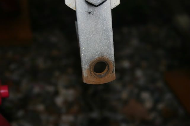

I took off one of the leaf springs today-- snapped off one side on each of the 2 u-bolts. I'll take it to a trailer parts store tomorrow and try to find matches for the hardware. How does this shackle look-- I watched an etrailer video that said if the bolt hole is not enlongated, it's ok to reuse. Mine's perfectly round, just a little rusty:
