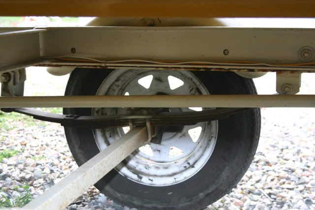

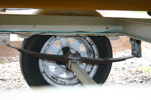

How do these leaf springs look?
mike64
Apr 10, 2008
1,042
Are they shot? I'm thinking they should have more "bow" to them.
marlboro180
Jun 23, 2009
1,164
Re: How do these leaf springs look?
Yup, they are done, or there are 2 boats on that trailer.:D
HAV2FISH
Oct 24, 2008
519
I concur, replace them. There not expensive and easy to replace. Also replace all the hardware at the same time.
Frank Acampora
Jan 19, 2007
12,004
Third opinion--replace them. They are not just sagging: You may have one of the middle leaves broken at the center bolt. Shame--other than that, they look in decent condition (in the photo).
mike64
Apr 10, 2008
1,042
OK, pretty unanimous then. :p Thanks for the replies!
Ayuh,... They look, Overloaded,.... Severely...
go weigh your rig.... don't guess.... then buy new springs that meet or exceed that weight.... those old springs are beyond rebuilding... they are trash
