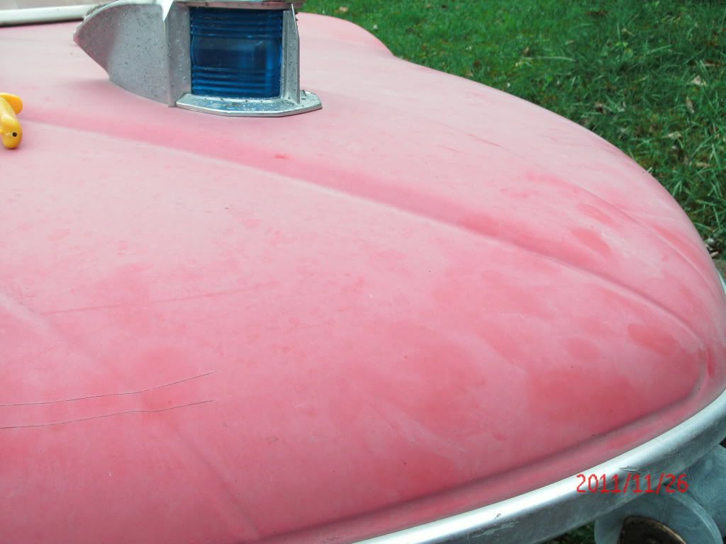

Pix in either thread would be helpful....So we'll start w/ that:
Easiest to start w/ a free photobucket account. Once you get the pix loaded from your camera into your computer, photobucket will walk you through uploading the pix to your account. Do yourself a favor & break the boat down into groups & make a folder for each group. It will make it easier for you to find the pix you're looking for, and post it to your account, if you don't have to scan thru several hundred pix looking for the close up of the transom bracket or whatever.
Once you have pix loaded into your photobucket acct, look for these image codes under the pix you want to post:
Share|Edit|Delete|Move
Email & IM
Direct link
HTML code
IMG code
Highlight the text in the box next to IMG code, use the right click mouse button & select copy. Start a reply post toyour thread & then right mouse button again & select paste. You will paste something that looks like this:
{IMG]http://i1246.photobucket.com/albums/jbcurt00/GEDC0347.jpg[/IMG}
And it will turn into a large pix that looks something like this:
The pix will be nice & big, and easy to reference with the text you add asking a question or whatever about that pix.
