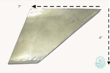

I have bought a boat with a 1996 mariner 30 that has a damaged skeg. I straightened it out and plan to weld on a replacement cast aluminum skeg with 5356 but I have one problem...
How long is this supposed to be? I'm assuming maybe 1/2" or so below the prop? Any help would be great, thanks!

Is that a Mercury Mariner or a Yamaha Mariner?
I don't think the length of the skeg is critical however.
53,079
Should be a tad longer than the prop

You could put 2 straight edges on the undamaged parts of the skeg, and see for yourself the length and shape.
