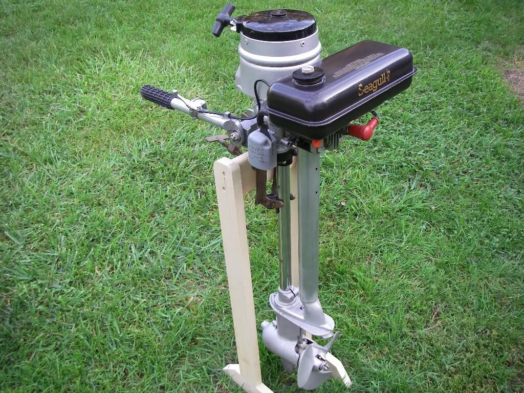

guy48065
Aug 31, 2008
575
I don't have any construction details--but this one was very simple. Made with hardwood it was plenty strong enough for a small outboard. It took a little fiddling to get the angles right so it was balanced and stable. "Large obnoxious ones" are that way to accomodate a huge variety of sizes & weights.
