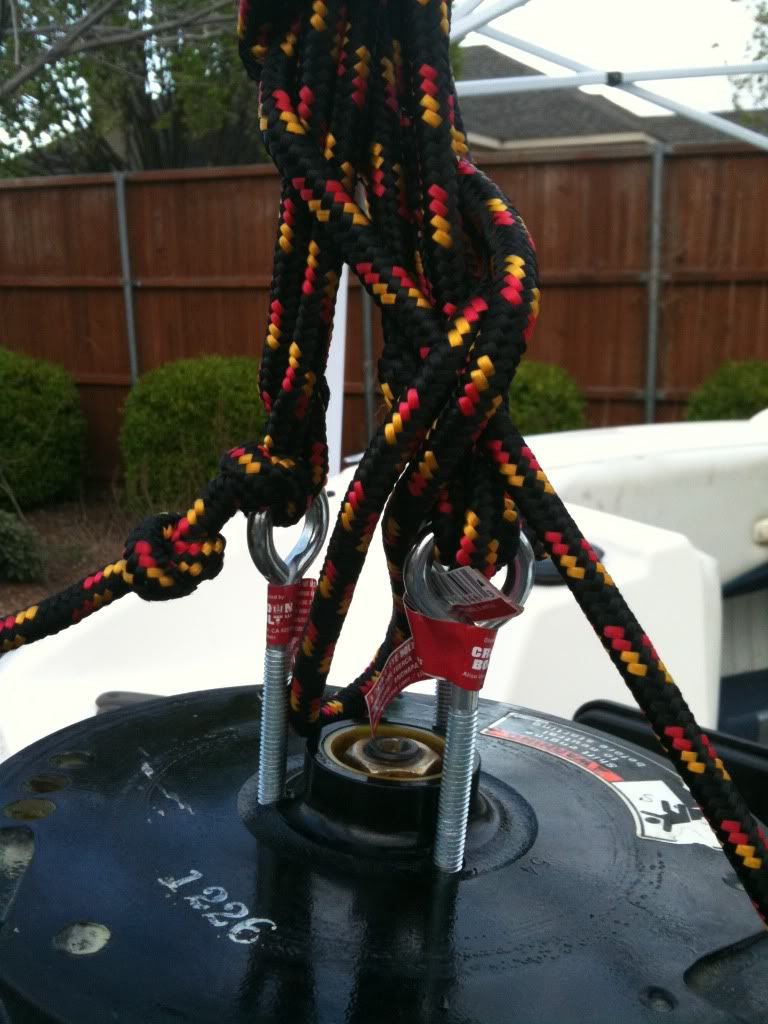

Re: How to lift 90hp force outboard
There is a special eye hook that you can buy, but this is how I did it.
I lifted a 150 hp Force with the 3 bolts in the flywheel...no problem.
