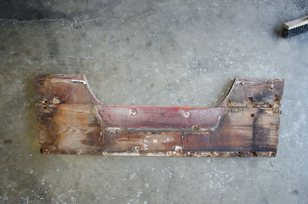

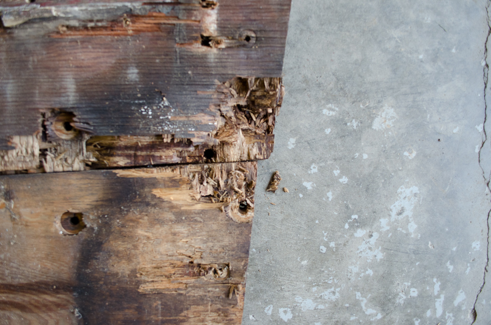

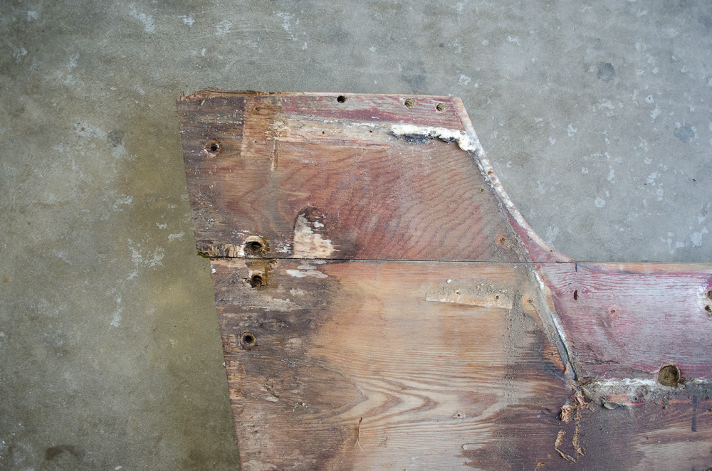

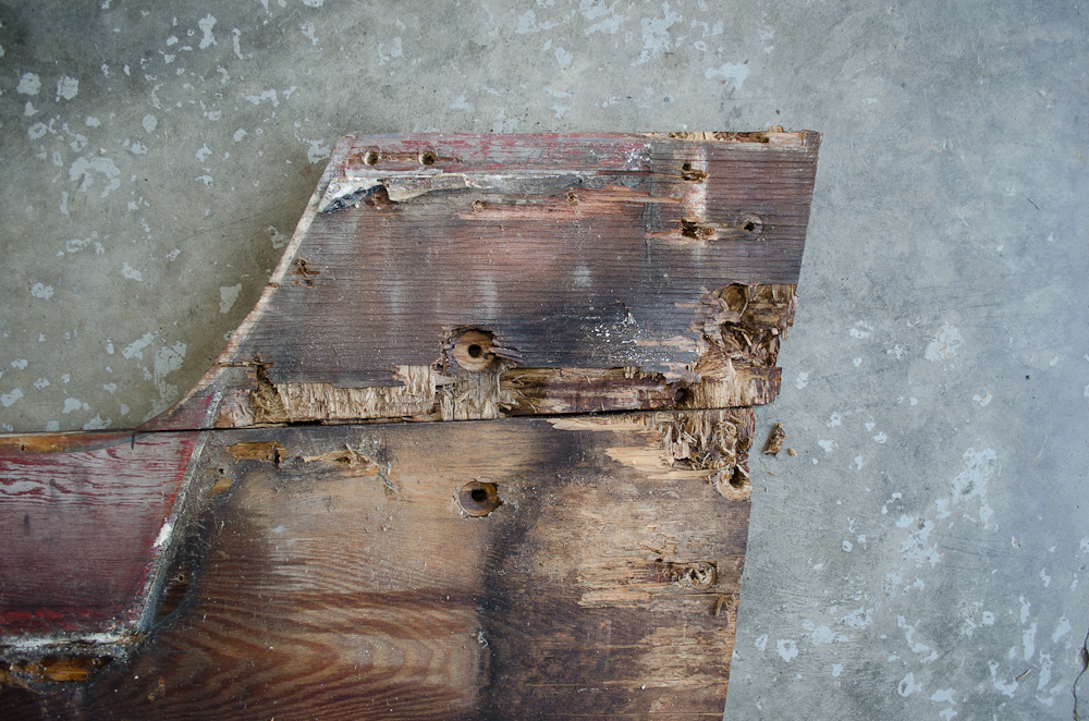

As to your original question of "How to validate the condition of the wood inside the transom", my recent experience tells me that without a good solid visual inspection, you cannot.
I did the jump on the anti-vent plate test, with an experienced hand to help me evaluate and all seemed solid.
Then this happened:
Lo and behold this is what was actually in there:
I think, when a boat is of a certain age, depending on how it was cared for (if you can even tell the complete history), you're almost better off assuming the transom is going to be wet / soft / rotten.
