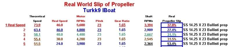

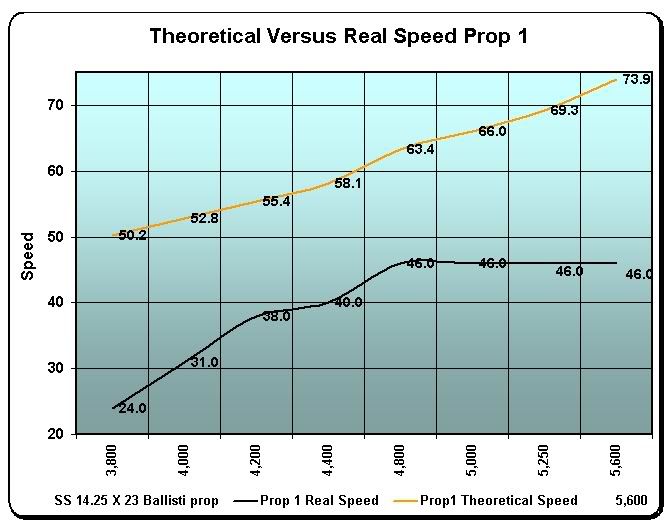

Joey, if the numbers you gave me are correct, they make no sense. You either have a tach that is wrong or you have a prop that has a hub that is slipping.
Here are my numbers and a chart to show you what I mean.
It is just hard to imagine you had BOTH problems.
I am very glad to hear you are on the right track at last.
H

Well the slipping prop did occur to me, but the reason I didn't get on it was that I found it hard to believe that once it started slipping, it slipped at the same rate consistently, at least per what I gleaned out of you.
If it is in fact slipping, then all bets are off with what I told you in your PM. You need some hard data before you move on to another prop.
