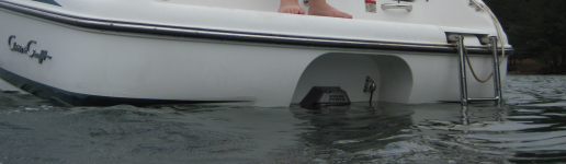

If you can post up a pic of the boat in the water specifically the transom so we can see how high up the water is against the transom mount assembly.
Here’s mine...the Cobra transom mount & the Volvo SX mount are nearly the same. The cat is fake and keeps birds from using it as a toilet lol!

Here's my boat sitting in the water with everything it normally would have on it except for people. I also found a close up of the transom assembly before we had the platform. My wife (petite) is sitting on the back. Doesn't seem to be a significant difference in how the boat sits in the water with and without the platform based on where the waterline meets the green trim. I'd estimate the platform weighs about 110 lbs.

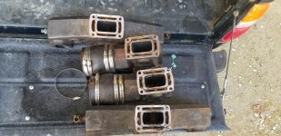

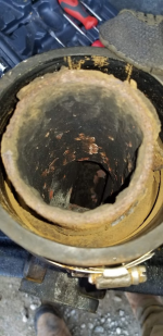

Here are my elbow gaskets from this morning. There's no line of rust that I can tell on the gasket, however there are what I would call specks of rust here and there inside the throat of the elbow. The opposite end of the elbow which connects to the exhaust tube leading to the lower unit looked awful though. I suspect that any signs of rust there had to come from water coming up through the exhaust or is there a level of rust which is to be expected due to moisture in the air and humidity? Should the interior of the elbows be completely void of any signs of rust whatsoever? Overall it is black and sooty. I also pulled the center spark plugs directly below the joint and there were no signs of rust on them. The plugs were replaced following the beach incident. I will be at the least changing the manifolds and elbows as it is beyond time.

The mans and elbows don't look bad, sealing surfaces could use a flat file or other maybe. The elbow exhaust end is erroded some, and if you were having trouble with reversion then I would think more about it at that location. Appear to be fresh water
