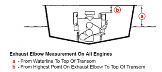

Hold it. Seems I measured incorrectly.
I had followed this illustration. A minus b for me is 15".
What you wrote makes sense, as the bottom of the elbow is the highest point water would need to overcome to flow into the engine? If that's the case, the bottom of the elbow bend is 3 3/4" below the top of the riser. So the highest point of my exhaust system is at 11 1/4" above SWL.
If I need to be above 14" over SWL I need to gain at least 2 3/4". My existing "standard" risers are 7 3/4" tall, so if I go to the 11.3" "tall" risers I'll gain 3.5" which is enough to put me over 14" above SWL if I understand the measurements correctly now.
Last question - if I go to the taller riser, can I make it fit with the existing Y-pipe?

With regard to the bulletin, Note 5 states "ail kits in this group also used for earlier engines with SX.M and Dp·SM drives". Note 5 is noted against "4.3/5.0/5.7L Ocean Series" which lists kit 3888846.
Having said that, You measured your riser height correctly the first time and as you got 15" you should be OK. Minimum is 14".

Well this blows my theory out of the water! Attached is a page from the newer 5.0 GXI-P manual. Although it shows a better way of testing static water level, it also clearly shows a water level ABOVE the "Y" pipe! It also says load to maximum capacity.
I would test it per this latest page and if it is 14" or higher say it's good, if not do something about it.
