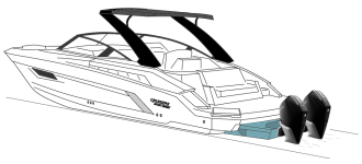

I am going with an outboard bracket that will also serve as a hull extension, what I am calling an 'extendo-bracket' :LOL: .
In designing the bracket, I wanted to take the shape of the boat's transom into consideration.
The 'flat' part of the transom is inset quite far and covers only about half of the boat's beam.
If I went with a traditional bracket, it would be only about 58" wide. Certainly wide enough for the twin engines, but probably falling short on the hull extension/planing surface criteria. So, I decided to go with the 72" width as a compromise, not messing with the trim tab areas.
Another consideration was fiberglass vs. aluminum. If I go with aluminum, I would probably want to have a space between the top of the bracket and the underside of the swim deck (corrosion prevention consideration). This would mean that the bracket would need to 'hang' off the transom. Considering the proposed length of the bracket ( 65") . . . that seems like a lot of cantilever.
If I go with fiberglass, (probably Coosa-cored fiberglass construction) I can more readily attach the bracket to the underside of the swim deck, making it be more like a hull extension. The contact areas of the extendo-bracket will be something like this . . . (shown in orange)
The extendo-bracket will have the mating contact areas as illustrated below. . .
The installed extendo-bracket will look something like this . . .
I am planning on a 2" step of the hull extension portion and its planing surface length will be about 40".
There will be adhesive and lots of fasteners holding the extendo-bracket to the boat.
Probably about 80 fasteners (SS bolts) in total. My technical assessment is that 'it's not moving' . . .

One thing that I am still thinking over (or maybe over thinking :LOL: ) is the 2" step (up) of the extended planing surface. I see a lot of hull extensions that are done with the added planing surface flush with the existing hull, rather than a step. I'm thinking the step will allow some air underneath the added planing surface, much like a stepped hull design.
I'm still looking for some real-world examples.

The more I read about the design of hull steps, the less inclined I am to having the 2" step. Here is a rendering of the E.B. without a step. There is a strake right at the chine of the extension (not previously detailed) that I could run to the end of the extension.

After some review of the boat hull (from pictures), I realized that I had the hull strakes slightly off. The upper strake does not line up exactly with the chine of the hull extension. Here are a couple of pictures with the strakes shown and adjusted accordingly.

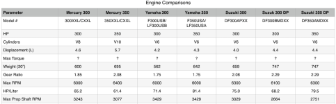

I've compiled some data about the engine choices, seeking to gain some insight. I've noticed that the manufacturers don't readily publish Torque/HP curve data. So, it may be anyone's guess as to how the different engines are getting to their numbers. I have not found any published power curves for the outboards. :unsure:
I find the Mercury numbers of HP/liter interesting vs. the others, but if I had to guess, I would imagine that low-end torque may be their strength. Since my boat is fairly heavy for its size, I tend to favor low-end torque, because without it, you may never see the high-end HP. :LOL:
I've also fancied-up my drawings and have been working out some of the details.
Having the boat with the full original swim deck and the boarding ladders to each side should be a big 'plus' vs. how CY does their reduced swim deck.
There is going to be about 40" of additional planing surface, which should help the boat come on plane and ride better. (time will tell)

Yam and Suz are using superchargers which will increase the maintenance and reliability IMO as well.
Looks like they are not supercharged, the Yam needs premium fuel but not Suz

You might also compare cost of extended warranties, this is probably insight into how much the manufacture knows they will cost over X years. I think Muc had pointed this out on a thread a couple years back.

While the cost of outboard repairs may well be higher due to parts cost, most salt water boaters are choosing the outboard option no one seems to want to deal with the added maintenance sterndrives need every year….

As for extended warranties- Yamaha seems to be about 15% lower than Merc and Zuke.
It looks like the standard warranty is 3 years for M and Y, 5 years for S.
I’m not a fan of warranties anyway, probably would stick with the base warranty.

The pricing for extending the base warranty looks to be $1,000 - $1,200 per year, which seems high, as that figure would be an average. Not sure how much of it is clear profit, but at ‘flat’ rate, every 10th owner would have a $10K repair bill each year. 🤪
52,293
That warranty is an accrual amount, based on about a 17% failure rate, and the average price of the parts and labor
