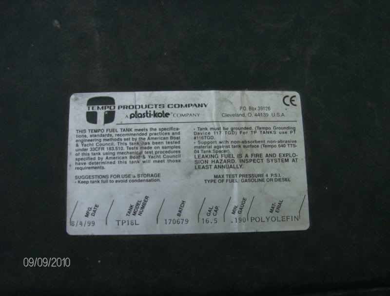

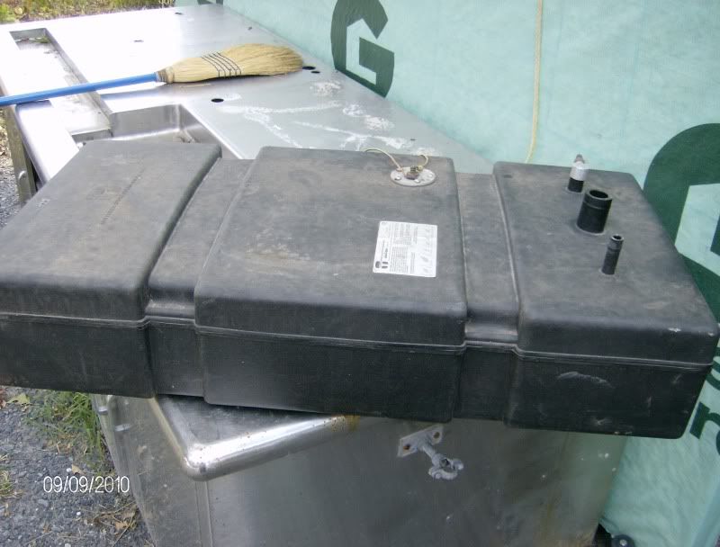

Here ya go. I haven't figured out how to attach pics to a pm.
19 wide x 37 long x 9 high (the 9 high includes the fill & overflow neck)
