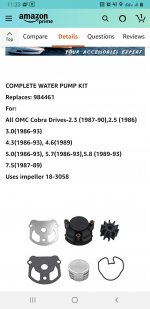

What was the kit part number your using?
Through Amazon UANOFCN 984461

The part number is correct but coming from Amazon it can be rolling the dice. Might be good but may also be counterfeit. It says replaces that number.
Does list sierra impeller 18-3058
Might also be how your assembling. The housing should mount flush with no need to press and pull into place
I'll double check to see if it sits flush or not. I'll report back. I don't believe it referenced the Sierra number. I'll order the oe omc part number even if the old setup does sit flush. Worst case scenario if it ends up being the same and its something else is wrong I'll have a backup.

We can't post websites here but what you need:
OMC part #s
0984461 water pump repair kit $48.95
0984745 impeller housing $39.95
this way you're starting out with the right parts that will work well together. If you have an Evinrude dealer local to you, they might be able to get them in a couple of days.
