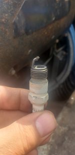

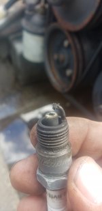

Ended up being the same issue, made it out no problem. Anchored up spent 4 hours on the island, loaded up and left. Less than two minutes into the trip back the engine quit. Came in on the kicker again. Everything that happened before, happened again. Got it home and it starts right up. Took it out last weekend to try and replicate. It did! This time im ready with tools in hand. Pulled spark arrestor it's getting fuel. Started pulling plugs. Starboard side looked good. Pulled the #1 port side completely burned up. Pulled #3 port side it's even worse. #5 the ceramic housing cracked while removing but the plug looked ok on the inside. What brand would anyone recommend? I've always used champion, but at this point maybe reconsidering? Anyways, This leads me to believe the port side exhaust manifold it's clogged causing it to run hot. And my temp sensor is no good. I pulled all the drains and ran the hose to it. Fired it up and sure enough nothings coming from the port side manifold. I tried pushing some compressed air through the inlet side, no luck. Went up from the drain, bingo, blew out nasty rusty water. Hooked it back up and ran it for fifteen minutes. At this point I'm seeing that my temp gauge isn't working at all. Everything appears to be flowing though. I tested the sensor, is indeed bad. When I ground the wire it pegs the gauge. Pulled the sensor. I just need to get my hands on another sensor to ensure my temps are dialed in. Anyone know a part number on that sensor? I googled it and everything is showing the part with a 3/8 opening I'm fairly certain it's much larger. (Came off with a 23mm socket!) Lou im definitely looking into a complete exhaust conversion after seeing the condition of those manifolds! At this point I just want to ensure that everything else is in working order, run it through the paces and then get the exhaust parts orders and swapped over. Will I need to pull the motor to do that conversion? It didn't appear I had to, but you would be the expert.

You gotta get the temp gauge working but for now get an IR temp gun and use that to measure temps. Check:
Intake manifold right under stat housing, should be about 10-15 degrees below the rating of the thermostat (standard is 160).
Top of exhaust manifolds (elbow section)
Mine were usually about 90-100 at idle and would get up to 135 after coming off plane but would cool down in about 5 min of idling. Engine temps on gauge 160-175.
Those plugs are trashed. I would check the base timing and total timing advance to make sure it’s not too far advanced. Base is 6*, max centrifugal advance is 12* for a total of 18* at approx 3200-3500 rpm. From my OMC manual. Use AC Delco Marine MR43T plugs.
About the manifolds if they are running hot remove them and make sure the 4 outlets are not blocked. Just pick up a set of manifold to block gaskets. To remove you need to slide the rubber exhaust hoses down the Y pipe first. Then the manifolds will slide right off the studs.
What I used to do was to spray silicone spray on the Y pipe below the rubber hoses. Then get a really thin screwdriver and slide it up between the hose and the Y pipe, to work loose the rubber hose...they get baked on from heat. Then slide the hose down. If you don't do this first the manifolds will not come off. Once you get the manifolds off you can clear out the 4 outlets and hook the hose fitting up to a water hose and test them for flow.

Nothing wrong with Champion, took at set out of my 20 year old Rinker and they where still doing fine. Did install MR43T because I got a deal one about 50 of them some time ago
Any plug will do what yours did when they get that hot.

Thanks guys for the feedback, do you think that the lack of flow would cause the engine to seize and this happen to the plugs? I'm assuming this is why when it dies it acts like it's seized until it cools down. It would also explain why it cranks like a dead battery until it cools down enough to crank normal again. this is my second boat the first one had a two stroke outboard, and I've heard champion is solid so that's what I've put in them. the ceramic housings cracking on two of the plugs makes me reconsider. But honestly I'm sure this would have happened no matter the brand. Does anybody have a p/n for that sensor? I've checked everywhere local and every one is pulling out 3/8 thread sensors. This one is 1/2 inch. Lou is there website you recommend that I can get the entire two piece assembly for both sides? I'll be able to get my hands on an ir temp gun next weekend I think If I can find one this weekend for a reasonable price ill try and pick one up. Once again thank you for the feedback! You guys are super helpful.
