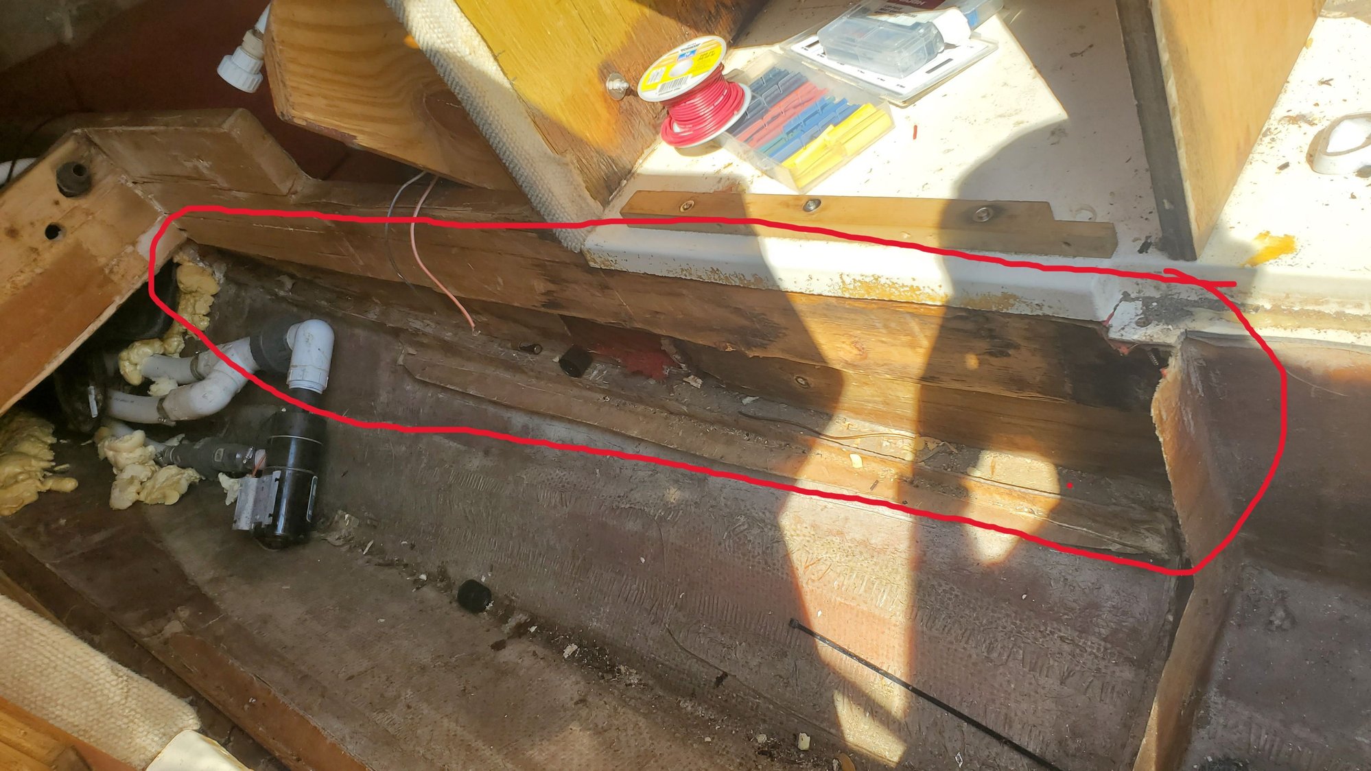

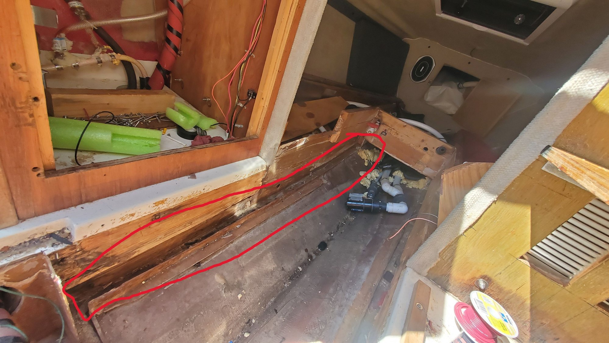

It looks like he cut a section of stringers out. I'm not sure if they were rotted, or if he needed room and just never got back to it. I pulled up the center deck board and removed the fuel tank to inspect the rest of them, and I'm not sure I like what I see. I'm new to boats, so I could use some advice.
Missing Stringer
Missing Stringer
Missing Stringer
Missing Stringer
Missing Stringer
Missing Stringer

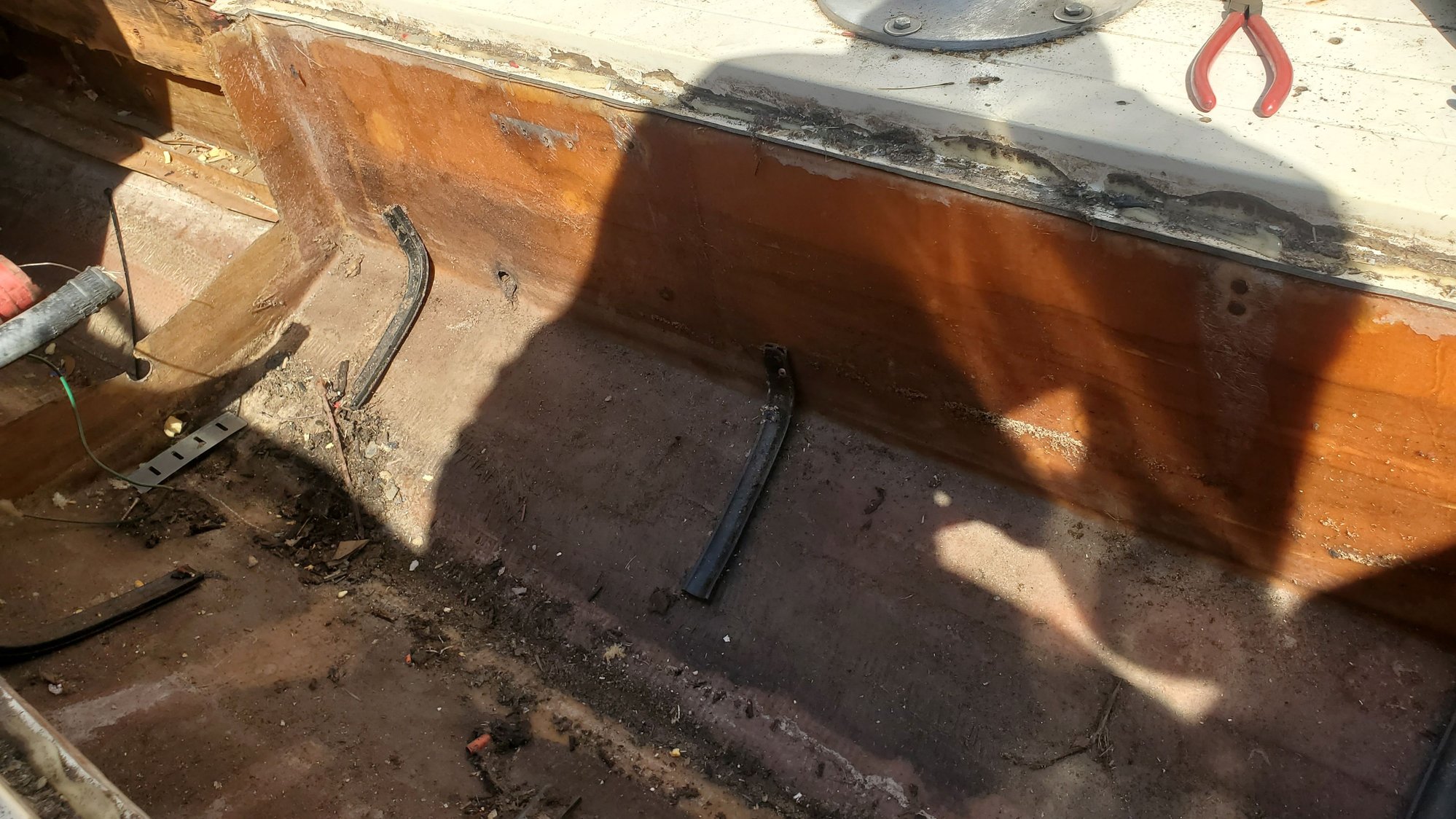

Screw driver punched through rotted wood

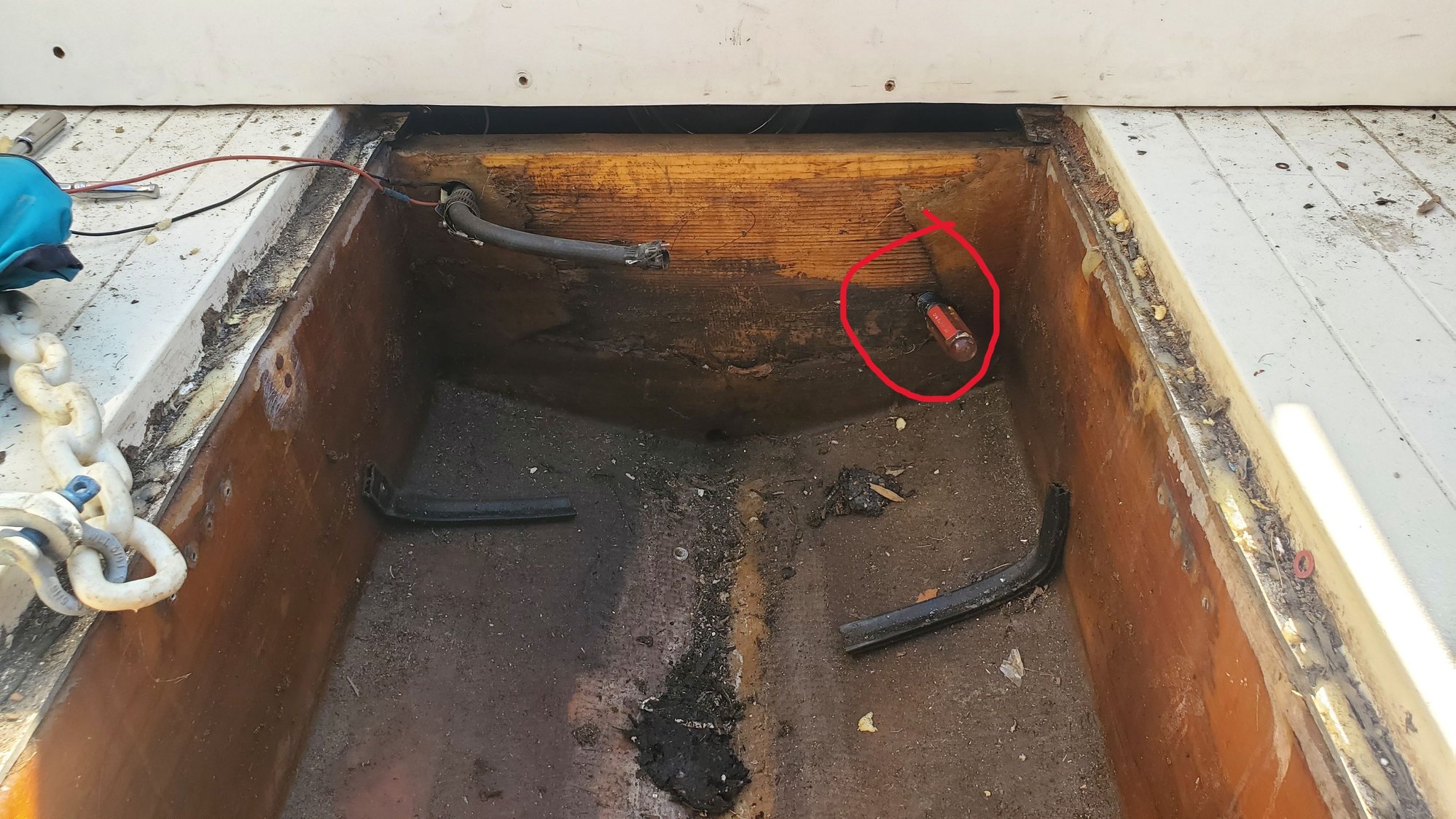

Where gas tank used to be. Worried about dark wood near bottom of stringer.
Cross beam near the engine. Completely loose and so rotted that a screw driver punched through it.

When I got the boat, I was under the impression that it was in generally good condition, with the exception of Grandpa's new additions (we weren't sure of the quality of his work in his old age). I was prepared to undertake a little bit of a project to get on the water. But now I am fearing it needs a total overhaul. I'm interested in having a boat and doing some tinkering, I'm not sure I'm interested in a total overhaul. I've painted cars and done some engine swaps, I'm handy, capable and hard work doesn't scare me. I'm just not sure this is where I want to invest my time right now.
How bad is this?
Is it worth fixing?
What is the ballpark estimate of having this repaired?
Doing it myself?
How involved is it?
Do I have to take the whole deck up to do it?
If it's not worth fixing, how much is it worth as-is?

Your pictures didn't work for some reason. Iboats has a file size limit, so try reducing the size/quality of the pictures.
From the descriptions though, you're looking at a total structural rebuild. The stringers are a total loss, transom will be too, and the floor will have to come out to do the stringers. That's a huge job. Months of doing it after work every day, grinding fiberglass and getting the dust everywhere, resin fumes, and thousands in materials.

Closer to the 10k than the 1k. Prob need to spend a week or two digging in a bit more to see what you got, incliding the transom.

It will cost more than 1K, depending on the rot I would estimate 3K and that is knowing the motor and drive only need maintenance.
I would estimate 2 months minimum and that means your a quick study with fiber glass work

While it looks cool, your best bet is to part it out if your not gonna put in the time and money. Keep in mind, most fiberglass boats were designed for a 25 year life span, your well past that, so ......your call !

I would ballpark it somewhere closer to 5k and 6 months, assuming you have a full time job and other life responsibilities, plus the inevitable needing a break from it. Needing to lift the cap depends on how it fits on the inside. If everything that touches the floor is removable from the sides then no, but if the sides come all the way to the floor and are part of the cap then probably.
Under the floor, and between all the stringers the voids are full of (likely saturated) flotation foam. You'll have to get that out as well, and replace it if you decide to rebuild.

Yes, closer to $10K than $1K and closer to years than weeks. It is hard to tell from the pictures of the cuddy cabin if the stringers were removed or just exposed.
One thing you need to factor in is knowledge, which you are starting out at a fairly low level.. This will increase the time involved as you will need to learn about boat restoration.
