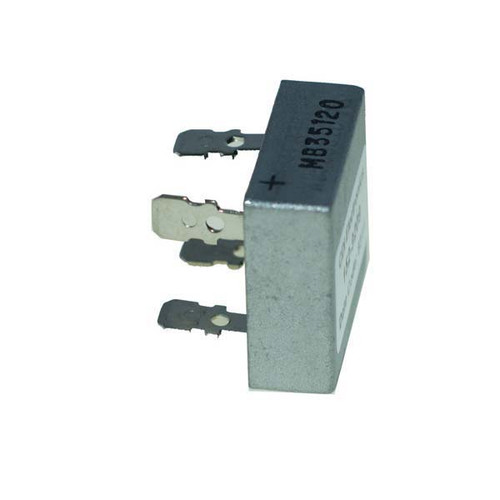

This is the rectifier from CDI Electronics. If you looked at the wiring diagram you would see four connections. There are two and three wire versions though. The third wire goes to the middle connection if necessary.

The rectifier will have two connections for the alternator coils and one for the + 12 volt out and the fourth for ground or if three terminals the ground is made through the metal part of the rectifier internally.
Often the AC inputs are marked with ~ and the output +
