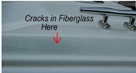

In my experience any bubbles {blisters } were caused by wax or oil residue impregnated in hairline cracks and you can`t get rid of them as long as the cracks are there......any of them present ? sample
