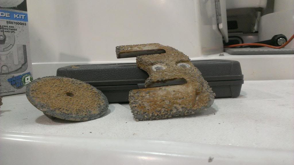

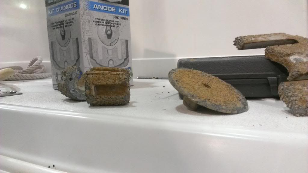

KnotConnected
Aug 15, 2012
221
Re: Is a little corrosion normal?
I figured you might ask that!
I Bolted up new anodes before I put'er in the water this past season, and just looked up the receipt to verify they were indeed MG. I've since replaced them with fresh anodes for this coming season, but took some pics of the old ones before I 86'd 'em.
http://i46.photobucket.com/albums/f117/n915aa/IMAG1206_zpsd979a60c.jpg
http://i46.photobucket.com/albums/f117/n915aa/IMAG1207_zps06deb333.jpg
IMAG1204_zpsfe256d41.jpg Photo by n915aa | Photobucket

WOW. Those look really bad. I think you may has some issues with the shorepower.

Compared to what I am used to seeing with salt water, those anodes do not look too bad. . . It seems that the outdrive might have taken more of a 'beating' than the anodes :noidea:
One thing that I did this past season in terms of corrosion protection, which seemed to work fairly well, is that I painted the dual props with Cold Galvanizing compound (3 coats)
Having a 'weak' metal directly on the stainless steel seemed to help avoid corrosion around the prop hub that was happening to my outdrives in the past . . . similar to what you (the OP) are seeing after your 1 season.
Here is a picture of the outdrives/props after a bit of power washing.

Those anodes are doing their job and look fine. That is what they should look like after 6 months. Be sure to get a propshaft anode, it will help. This is the reason why merc added the propshaft anode and 1 additional pancake anode to the cavitation plate in 2004. As others have suggested, you need to check to make sure your Mercathode is working. I will try to find an article I read that suggested running 2 mercathodes in parallel to increase protection. Do you have trim tabs? Are they stainless, and do they have anodes? Have you seen the outdrives of any of your dock neighbors? Are they having the same issues? If it is just your boat, it is much easier to isolate the issue.
