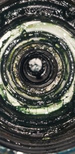

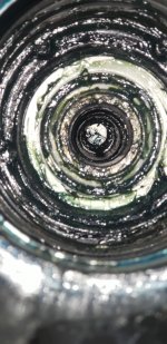

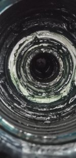

hi guys well im exhausted and beat trying to get the darn drive back in. Im pretty sure its way off. I can see the coupler raised from the bottom, im assuming engine is to high ?

does it look off to you bondo ?
You need an alignment tool to determine if the alignment is off Cant tell from photos.
put grease on the tool, put it into the coupler , the coupler will leave witness marks or marks in the grease to allow you to tell if it is centered. If you google mercruiser alignment tool you can find them relatively cheaply . If coupler is indeed high you need to raise your front engine mounts.
when you try to install the drive are you making sure the shift linakge is lined up, drive is in forward with pressure kept on prop in CCW direction so you can turn the prop and thus inout shaft to align the splines?

yes everything is aligned but i think if i can rotate the drive it might go in. But i tried moving the prop CCW bit it wouldnt move at all? when the drive is out it will move but i have to put a lot of force on the prop to move it and it makes a weird noise is that normal ? as if metal to metal rubbing. i dont remember my old boats being this diff to spin the shaft.

Question: Have you checked the alignment with a proper alignment tool?
For instruction on how to use the alignment tool and what to look for, watch the video called "Checking Engine Alignment". You are free to look at the others too. 😉

Try hitting alignment bar a few times to see if you can center the inner gimbal bearing. Many times they get out of center as you remove heavy OD. Pray you don't have rotten stringer that sagged after you removed shaft.

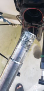

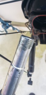

Ok i got the Alignment tool and it went in all the way but little hard to get out. I have to give it a good tug. I did see smears on the top of tool and nothing on the bottom

Stick the bar back in and give it a good hard whack with either your hand or a dead blow hammer - Up, Down, Left and Right. That will align the gimbal bearing to the coupler.
Next, pull the bar out and grease it twice as much - a good layer for all 2 inches of the smaller diameter end. Then do your witness mark test. Don't twist it as you pull it out.

ok i tried hitting it with a rubber mallet many times its a little better but not 2 finger in and out .. also seems like it doesnt seat in all the way only goes into the coupler about an inch , it can go in another inch or 2 if i tap it in with the mwllet but it will be hard to pull out
