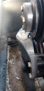

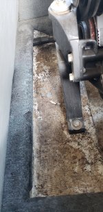

ok i hit it as much as i can its goes in ok not 2 finger but better then before.. i see greese marks all around about 300 degrees except for a little portion on the bottom where it looks like it didnt even touch the grease. so im assuming i have to lower the front engine mount? i only have 1 mount in the front ?
If you have done as others have suggested and your front mount is solid....
You have larger mounts in the rear, considering the complete transom assembly. I fear that you have a sagging assembly. A simple test is to hit inside transom with large rubber hammer or drill 1/4" holes all around it and test for rot. This sucks, I know!

Yes. Lower the front mount.

In case there is no more down adjustment take the front mount to a welding shop and have 1” cut out.

i havent done the front adjustment yet. Looks like the mount is very high. looks like I can move it down a good amount. Now just finding a 1 5/16 wrench

Ok i adjusted the mount and now it slides in like butter and bottoms out now 😁..BUT i dont see good marks on bottom of tool? I tried turning the nut maybe around 2-3 full turns CCW (lowering ) and still same thing? barley any marks on bottom but still slides in very smooth.. So i just gave up and installed the drive which went in like butter.. 😂😁
