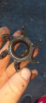

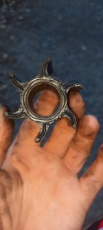

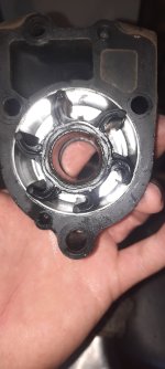

My engine is overheating and I am trying to track down why. Below are the pictures of my impeller. The video is of the outdrive hooked up to a hose running at idle and WOT. What do you guys think, is that how much water it should be pumping or should it be more? The outdrive is an old MC-1. Fresh-water-cooled. The overheating happened all of a sudden, 4 miles from the boat launch. Now it happens on the hose too. I will be changing the impeller regardless, but I would like to know if there is something else I should be checking.

Imperller is totally wasted, and the pump base is also damaged from overheating. If the video is of you on a hose the high rpm destroyed the impeller. On a hose your limited to about 1500 rpm max or impeller gets destroyed
Good to know. I have run it on the hose at high RPMs many times over its life. Will not do that any more I guess haha. Just ordered an entire new pump kit. Thanks!

Are you using an OEM merc impeller /housing or aftermarket OEM is worth the money

the picture is a breakdown of the impeller ...then inspect the outdrive and change the impeller ,,, parts are worn ...
