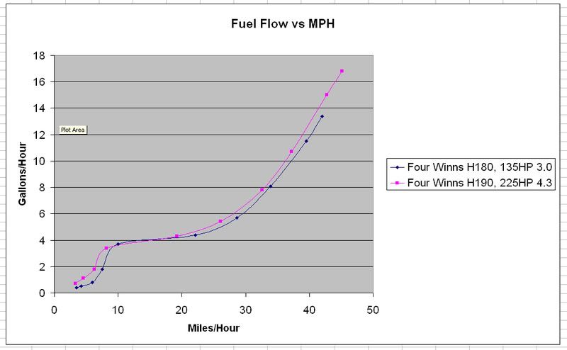

I wouldn't worry much about the fuel usage difference between a 4.3 and a 3.0. The 4.3 will burn about 1/2 gallon per hour more than the 3.0 with light loads. You put 3 or 4 people in the boat, pull a tube or some kneeboarders, they're probably about even. The 63% more power in the 4.3 will make it a much more enjoyable boat. Even if it does burn 1/2 gallon/hour more, if you use it 50 hours a year that's 25 gallons extra per year, or $100 at $4/gallon gas. If you are so close on budget that $100/year is significant to you than you probably shouldn't be messing with a boat!
Chart below was made from "Boattest.com" tests of a 3.0 and 4.3 Four Winns:

I don't know about that graph. Never saw a 3.0 burn more than 16 gph. And thats with doing wot for hours at a time.
Now 5-6 gph is what a 3.0 on a 19' Bayliner is what in my experience will be burned.
Now the question of ease of maintenance, 2 heads, 2 risers, 2 manifolds, all going to be replaced sooner or later.
If you look at the graph, you'll see that the 3.0 only burns 13 GPH at WOT. At cruising speeds of 25-30 MPH both engines burn around 5-6 GPH.
Can't help you with whether you believe it or not, the numbers came from Boattest.com, their tests have been dead accurate in the performance of both my boats.
I am actually suprised that a MPI v6 will only push this boat near 50. You can get that out of a cheeper Stingray with a 4 cylinder or almost that in a Bayliner 4 banger.
I think you'll find that the Four Winns is a heavier, "nicer" boat than the Stingray or Bayliner. Kind of like comparing a Cadillac and a Chevy with the same engine. If speed is an important factor you probably shouldn't be looking at 4 cylinders or V6's.

The graph uses the H190 with the 225HP 4.3L Volvo GXi, and the H180 with the 135HP 3.0 with a Volvo GL, both from the Boattest website. Closest Four Winns I could find.
If speed is an issue look at some real world test results. Maybe the factory tests with 1 person and a couple of gallons of gas. According to Boattest, the 180 topped out at 42 and the 190 did 45. 2 people in the boat, 1/3 tank of fuel, NO coolers or any other equipment in the boat. Most people will be going out with the boats loaded down heavier than tested. 1/3 tank of gas gives you about a 30 mile max range. I'd want a little more margin than that.
