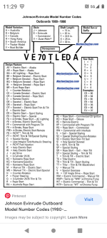

No worries, just thought you might want to know. Model number J=Johnson, 70=hp, T=trim and tilt, L=Long shaft, EN=year.
Here is the conversion.
