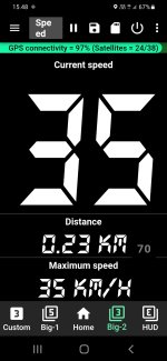

Not much difference with Evinrude 15. Boat 15.5 feet, 190 kg

The white motor is higher displacement compared to the blue motor.-----The ports are a totally different shape as well.

Yes, Johnson is 2000 and Evinrude 1992, OMC went from 13.2 to 15.6 cu in 1993. Question concerns horse power which could be same 11.2 kW (15 hp) in both. I haven't compared the carburetors, if Johnson has a smaller throat carb (9.9 HP) or not. If it does, extra power comes from somewhere else (jets?) Speed was roughly same or both motors.
HP= TxRPM/5250
Hard to believe a 20% increase in displacement didn’t result in an increase of torque as well.
WOT for both motors the same?
Bear in mind that rated and advertised HP can vary plus or minus 10% by law
