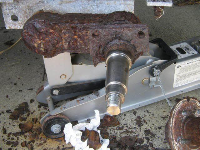

Re: Leaf Spring Corrosion???
Yes there is an alternative. Replace with torsion axle and replaceable spindles.
You trade rusted leaf springs for this.
You salt water folks really have problems I don't want!
Thalasso
Jan 18, 2011
2,879
No i still have leafs. I have a tri axle and still don't buy the koolaid that torsion is better then spring when pulling all this kind of weight. Smooth flat roads is one thing but where i am it's far from that. OP asked if there was an alternative to his setup.If you noticed i said i spray my leafs with PB Blaster lub.
