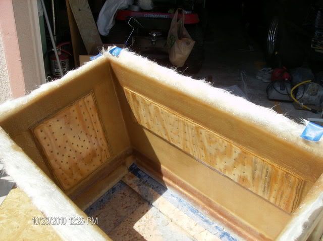

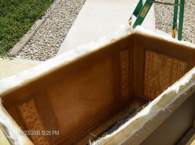

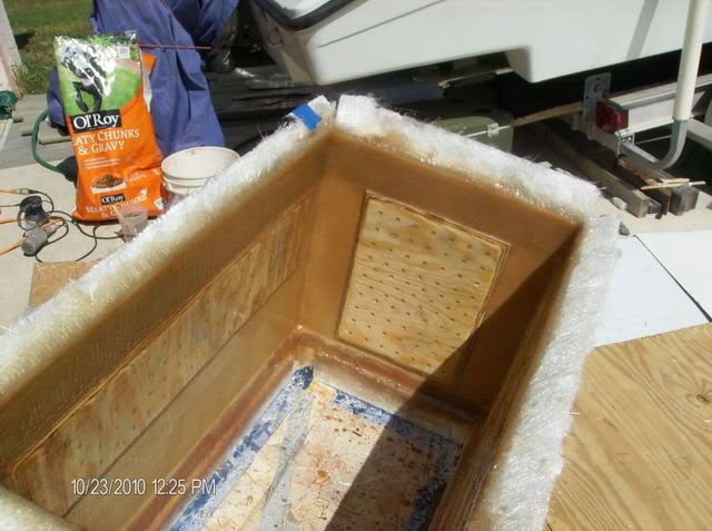

My 1st fiberglass project is just about done...

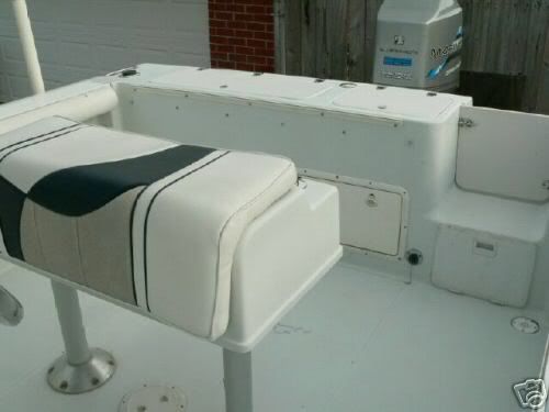

My leaning post consisted of a fiberglass top mounted on 2 aluminum pedastals.
Running in rough seas if would flex quite a bit and the gelcoat at the deck is showing a couple stress cracks.

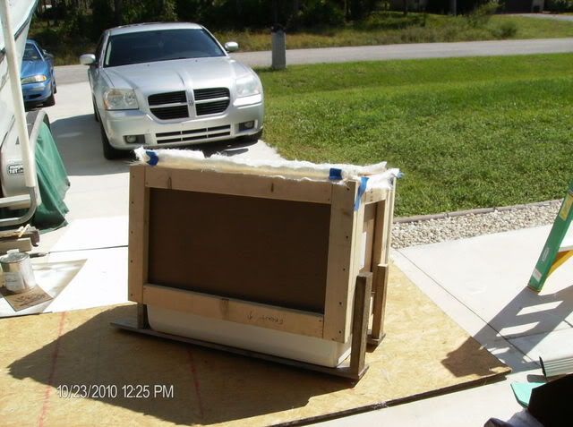

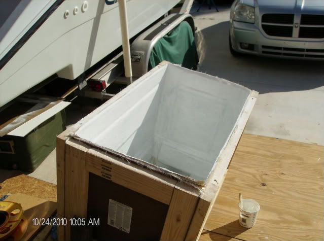

I prepped the top, (grinding, etc), and built a mold around it to extend it all the way to the deck.
I used modeling clay to form a radius in each corner and waxed the mold with 3 coats of mold release wax.
Lamination consisted of...
2 coats of gelcoat sprayed inside the mold
1 layer of 3/4 csm
1 layer of 1708
1 layer 3/4 csm
1/2" plywood coring
1 layer 3/4 csm
1 layer 1708
1 layer 3/4 csm
additional 1708 strips in corners and mounting points covered with strips of 3/4 csm
2 layers of 3/4 csm
1 coat of gelcoat, (waxed), brushed on

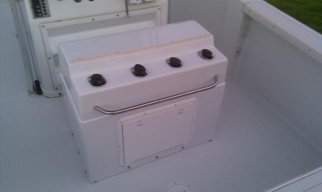

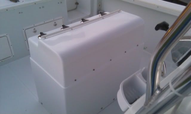

I should be able to get it mounted in the boat today and install the accessories on it and will post some pics, (if I can finish before sun down).

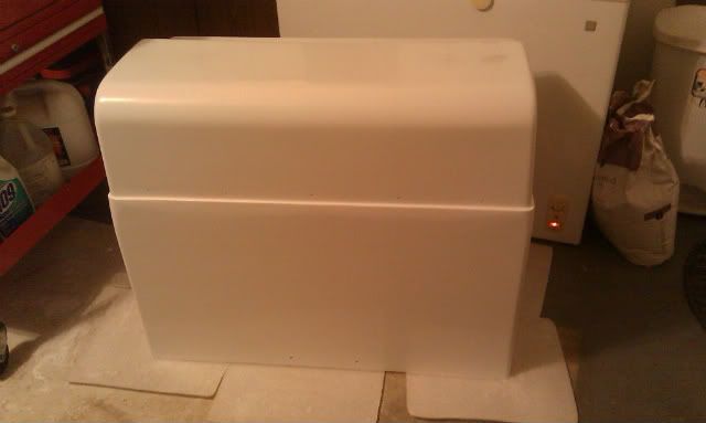

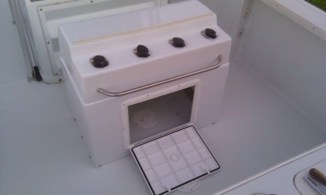

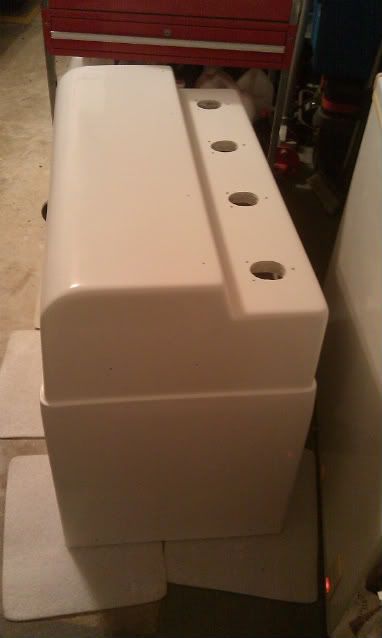

Here's a couple of pics, (cell phone), out of the mold...

very nice

Looks good, are you going to have access to the inside for storage?
In 1 of the pics in my 1st post, you can see an area which is lighter in color.
I used less layers of glass in that area for a cut-out...(saving glass and resin).
That area is now cut for a 16" x 20" hatch for storage access.
This leaning post has a 20" x 36" footprint and is 30" tall...lots of usable storage space.

Thank you ;) Looking very good. Nice job.

Came out good, I notice you didn't mold a mounting flange on the bottom edge, are you gonna glass it to the deck from the inside?
I did that on my console rather than rely on screws.

Very nice. You taking orders? lol. Looks factory for sure.
I mounted 2" x 2" x 1/4" aluminum angle to the deck and thru-bolted the leaning post to the aluminum angle on the sides.
