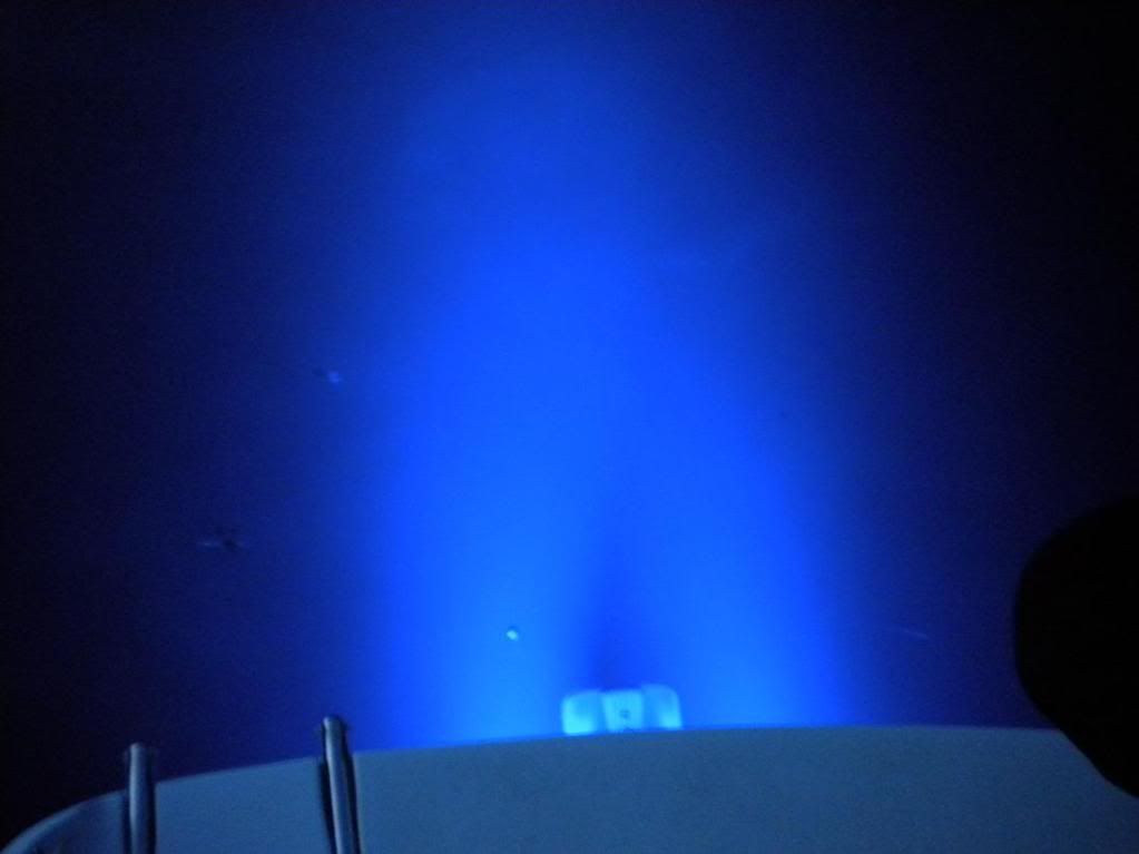

Re: LED transom lights
You shouldn't need to sand them down. You're going to bed them in with 5200 and that should take up any uneven surface issues. You sand the bottom paint a bit if you have any really big areas that need to be faired, but no need to go to the gelcoat.
I have both white and blue hooked to a 3-position switch. Both colors really attract fish in clean, clear water, but if you boat someplace that's tannic or murky, then lights are going to be a waste of time. These pics were in the murky waters of the St. Johns River (in Fl). When I go to the clear ocean water, you would not believe the light and the fish. Lights up about 15' behind the boat!
Go with a name brand, not the $30 per light knock offs. Seablaze, Underwater LED, etc. are all good lamps. Read the customer reviews and spend accordingly, but there's no need to do the $700 per light route. And don't be afraid to drill that first hole. Just take your time and follow the directions and you should be fine. Mine have never leaked a drop.
