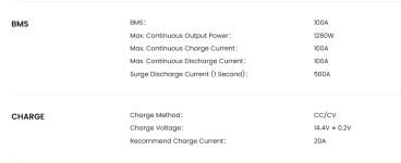

You can’t charge at 2C. The BMS doesn’t allow it!

Go to the Time USB website and look it up, better yet message them and do your own detective work.
I went on there...there is no mention at all of 2C charging. It does however say the BMS can handle 100A but they recommend 20A.1745977262221.png
