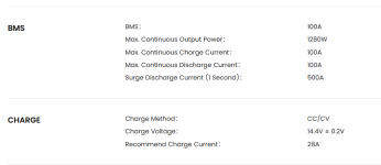

I went on there...there is no mention at all of 2C charging. It does however say the BMS can handle 100A but they recommend 20A.View attachment 407274
I have the 140 ah battery, bigger BMS system and different charging capacities according to Time USB messages sent to me. According to them the battery can handle a 2c charge rate but not recommended for longest life.
Here are the 140AH battery specs
